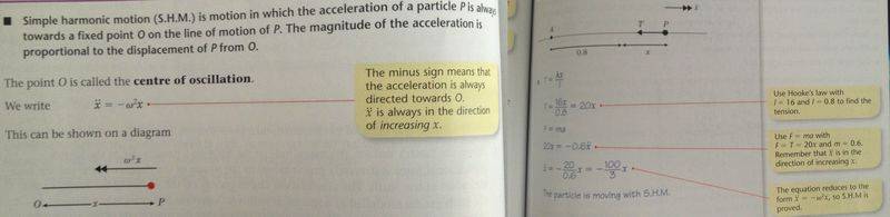

I attached a picture of two pages in the book:
The left pic is explaining the theory generally and the right is an example of proving SHM with a spring on a smooth horizontal table. They both have notes in yellow boxes saying x'' is in the direction of increasing x. Do you have an idea of what the book is trying to say? Thanks
Book is right that the acceleration is always directed towards O. But then on the next statement (x'' is always in the direction of increasing x) i think it changes the semantics of the word "direction" and it means just the slope of the line, sorry my english fail me here, but in greek we use different words when we want to say "direction" or "towards to" but in english the word is the same.
That phrase reads like complete gobbledegook. The Mathematical expression just beside it is, of course, correct. I guess the author had something in his head that suggested those words might help. They clearly don't. If in doubt about things like this, you should always stick with the Maths and look at another reference to check there is no error (equation layout / signs / etc.)
PS I wonder if he means that the acceleration acts 'along the line of x'.
It's a mystery - but you understand it so no harm done! :smile:
