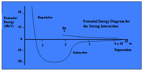

Your original question mentioned "force," and only force. There are also more forces that just EM and gravity, and those do not follow the same curve. These forces also do not interact through the EM field, the strong force below happens in the gluon field.
In the Standard model, EM, and the strong and weak nuclear forces are mediated by particles called bosons. There is a different boson for each force (photon is the electromagnetic boson, the strong boson is called a gluon.) Gravity is not included in this model, but there are modifications of it which include a graviton, which mediates force similar to photons, but it's got some problems, which is why it's not part of the standard model.

The only times the word "force" appears in the OP are in the phrase "summation of the difference of force", and in the next (and final) paragraph. And it is obvious from context that by the quoted phrase he means potential energy, which is what he wrote equations for and which is what he talked about in the first paragraph of the OP. Please read carefully.
(I note, btw, that the diagram you give, which is very useful, is also a diagram of potential energy vs. distance, not force vs. distance. So evidently you understood what was really being asked about.)
