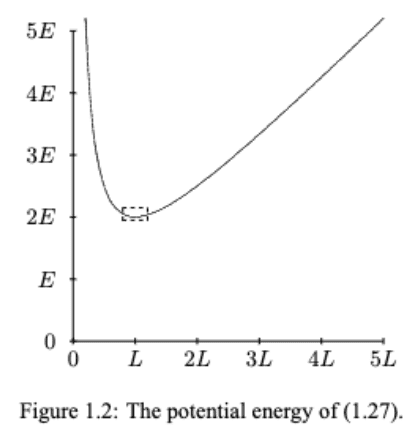

For example, consider the following potential energy
$$V(x)=E\left (\frac{L}{x}+\frac{x}{L}\right )\tag{1.27}$$
This is shown in the figure below
First of all, it is not clear to me what ##E## means in (1.27).
The minimum (at least for positive ##x##) occurs at ##x=L## so we first redefine ##x=X+L## so that
$$V(X)=E\left (\frac{L}{X+L}+\frac{X+L}{L}\right )$$
The corresponding force is
$$F(X)=E\left (\frac{L}{(X+L)^2}-\frac{1}{L}\right )\tag{1.29}$$
Shouldn't the negative sign in (1.29) be a positive sign?
We can look near ##X=0## and expand in a Taylor series
$$F(X)=-2\frac{E}{L}\left (\frac{X}{L}\right )+3\frac{E}{L}\left (\frac{X}{L}\right )^2+\ldots$$
Now the ratio of the first nonlinear term to the linear term is
$$\frac{3X}{2L}$$
which is small if ##X<<L##.
Just some constant energy. In the context of SHM it would be related to the amplitude.
No, it is right. Try it again.
