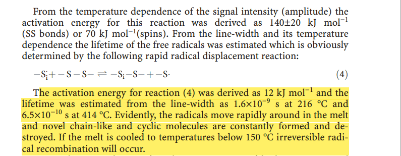

I have a question regarding the limitations of Electron Spin Resonance (ESR). I've read somewhere that ESR cannot detect radicals with short lifetimes.
I'm trying to understand why is that?
For example: a highly dynamic system like liquid sulfur at high temperatures, where sulfur chains with two radical chain-ends are constantly reacting with other sulfur molecules at an average rate of every 100 picoseconds. Will ESR be able to detect any signal in this case?
Even though radicals are fast to react, we have a steady-state concentration of radicals (on average radical concentration remain the same).
I would really appreciate any paper regarding this.

Hi,
Thank you for your reply.
I read in some papers about the radical trap methods developed because short-lived radicals are impossible to detect using ESR. Below, you can find a couple of them.
But I can't understand the exact reason:
- Is it because with short-lived radicals the steady-state concentration is too low for detection?
- Or does the problem lie in the transient nature of the free radicals?
When dealing with a highly dynamic system like liquid sulfur above 300°C, the steady-state concentration is high, even though the average lifetime of a radical is small.

Hi again,
Looks like my last message didn't go through properly. Once again, thank you for your response.
I'm on the lookout for any papers that talk about the limitations we're discussing. I couldn't really find any publications that go into detail on those specific issues. Do you think this method can accurately measure unpaired electrons in highly dynamic systems, like liquid sulfur over 170°C?
The radical displacement is fast (around 1 ns.) I've also heard that EPR can not capture short-lived radicals, but I'm a bit confused about what exactly "short-lived" means here. Are we talking about how fast the displacement reaction (propagation) or the lifespan from the initiation to termination?
Thanks!
I think you need to be a bit clearer about what you want to measure. If you are asking if pulsed ESR would be able to do time-resolved measurements of a process that takes 1 ns the answer is no. However, that does not mean that you couldn't use ESR to measure a "time-averaged" signal; as long as there are enough relevant spins at any given time to give you a good signal.
My suggestion would be to have look in a good book. For example
Principles of Pulse Electron Paramagnetic Resonance by Schweiger and Jeschke.​
