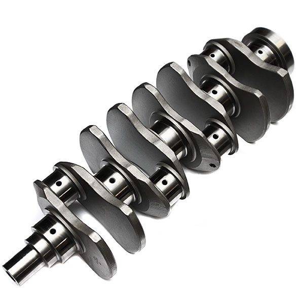

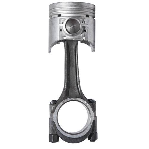

How is torque measured?... What is the lever arm in the case of an engine? Is an object attached to the shaft of the motor to determine torque?
For convenience it is measured at the wheels, so the lever arm is the radius of the car tire. Torque at the engine is calculated by multiplying by gear ratio.
This also translates directly to force for propelling the car forward.

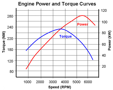

Yes. Note that power has to start at zero, but torque doesn't. The torque curve is much flatter, so the power curve steadily rises:

So, in general, the engine in car has the some maximum power, say ##500 W##, but different torques ##\tau## at different rotational speeds ##\omega## of the shaft. The transmission in a car is a group of rotating gears that allows the wheels to rotate at a speed larger or smaller than the current rotational speed of the engine. Without transmission, the wheels of the car would only be able to rotate at the same speed as the crankshaft (between zero and a maximum value ##\omega_{max}##), correct? When the car is not moving, a lot of torque is needed to win the inertia and the angular speed is small in low gears. The shaft speed is higher than the wheel's speed but more torque is applied to the wheel. The large output torque is due to the larger diameter of the output shaft. Randy mentions that the torque in the shaft is not affected by the shaft radius because the stress will be different for the same torque but changing ratio. I am still not sure about that point.
Torque seems to be important at the very beginning when the car is still moving slowing and not when the car has already reached a higher speed.
This can all be simplified. With a manual transmission, the propelling force at the tires (total) equals the engine torque multiplied by the overall gear ratio (engine to axle), divided by the radius of the driving tires. I’m ignoring friction and driveline inertia, which is a good first approximation. This is independent of speed.
