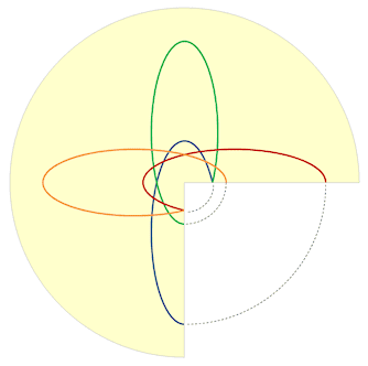

The direct cause is that space is very slightly curved around a large mass, like a strip around the surface of a cone. This is the main practical difference between General Relativity and Newtonian theory.
I think the simplest way to think about it is to imagine going round a large circle on the curved surface of the earth. If you take the strip of the surface of Earth in which you travelled, it cannot be laid flat without leaving a gap, so in going all the way round you have actually turned by less than 360 degrees. (The missing angle is called the "angular deficit" or "angular defect" and on a sphere the total angular deficit for the perimeters of the areas enclosed by any network of paths is always 720 degrees or 4 pi radians).
Similarly, space is effectively slightly "conical" around any massive object. If you follow space all round the sun, then when you pass the direction where you started, you will not yet have turned through 360 degrees, and that will actually occur slightly after the point where you started. Orbits are ellipses which normally effectively repeat every 360 degrees, so this effect, "precession", causes the orbit to repeat at a slightly later position each time round. The closest point of an orbit around the sun is called "perihelion" and can be observed in order to determine the precession rate.
(The perihelion precession of a planet is also affected by other planets, but that effect can be calculated using normal Newtonian gravitational theory in flat space).

Actually Bill_K and Jonathan Scott are both right but they are talking about different things.
The diagram above represents the geometry of a two-dimensional slice of space around the Sun, with the Sun at the centre. (See Flamm's paraboloid for the technical details.) The region between two concentric circles has approximately conical geometry. Imagine cutting such a region out the diagram with a pair of scissors. To make the region lie flat, you have to make another cut in the radial direction to open it out, and then you will have an annulus with a gap missing. If you now draw an ellipse on your almost-annulus, there will be a gap. This gap represents the precession.

Here is the simplest explanation of precession due to spatial curvature that I know of:
http://www.physics.ucla.edu/demoweb/demomanual/modern_physics/principal_of_equivalence_and_general_relativity/curved_space1.gif
http://www.physics.ucla.edu/demoweb/demomanual/modern_physics/principal_of_equivalence_and_general_relativity/curved_space2.gif
From: http://www.physics.ucla.edu/demoweb..._and_general_relativity/curved_spacetime.html
I understand that space is curving (Fig.1+2+3+4+5+6+7).
But the confusion is with references to Fig 8 + 9.
Fig 8 - “Similar Mercury executes its Newtonian ellipse in local space”
Fig 9. ---but the global curvature causes the ellipse to precess.
I understand; that:
Fig 8.; “ Newtonian space is without any curvature” and --
Fig.9 is with curvature.
So what the illustration only say is; That the curvature causes the ellipse to precess, - not WHY.

I tried this. The ellipse on my piece of paper didn't precess. What's the trick?
Draw the ellipse on the flat paper with an extra piece of paper in the gap to complete the shape. If you then close the gap, making the cone, and place the extra piece of paper adjacent to the join so that it still continues the ellipse on one side, it will not quite join up correctly on the other side. You could make it join to the next bit by keeping the extra piece of paper still and turning the cone under it to bring the join to the other side. This represents the precession from one orbit to the next (or at least the component of precession due to space curvature).
I found the trick to the original exercise. Don’t draw the ellipse directly opposite the cutout. That’s the one place where any drawing will not change orientation when the disc is pulled into a cone.
I’m not stating this as an insult. I know no one in this forum invented that exercise. But it tells me nothing about relativity. I am a little better at Paper Mache though.

  • #34
Here's a very exaggerated version (not to scale) with 120° precession to get the point across.
