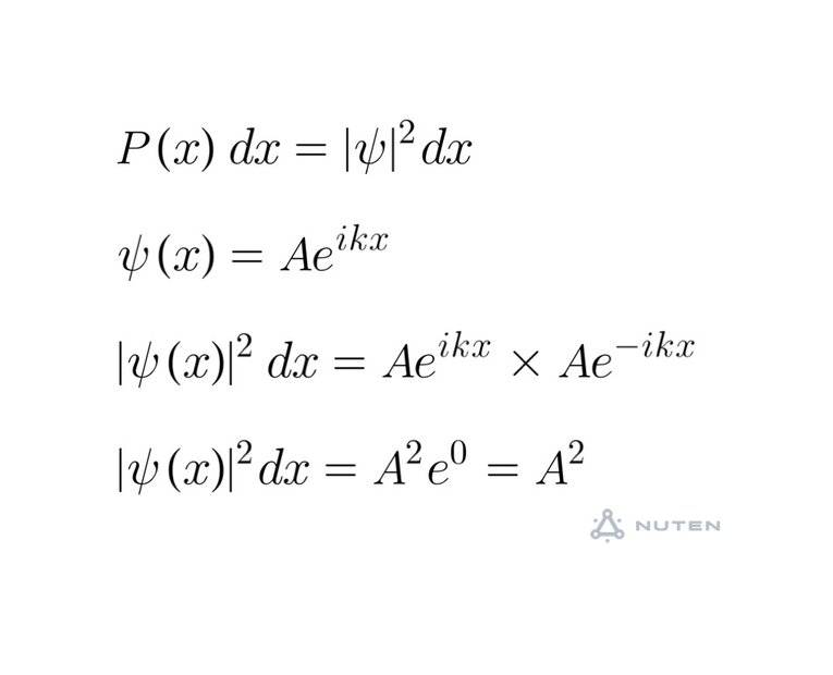

Again, I want to see how the probability density of a free particle on the x-axis with a known momentum is a constant. Is this right?

Technically it should be ##|A|^2## unless you assume that ##A## is a real number.
Likes vanhees71
Thanks. At my level of understanding, that was my assumption.

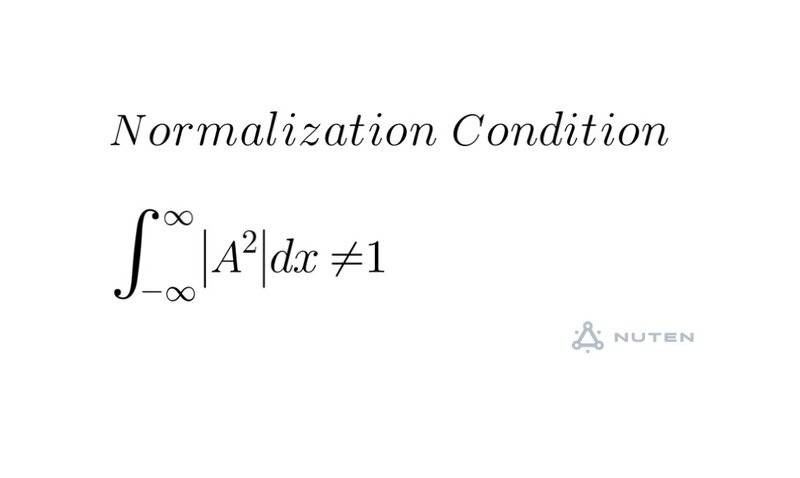

Note also that a function with a constant modulus is not a viable (physically realisable) wavefunction. That's an important point.

jjson775 said:
In my simplified case the modulus is not a constant
Yes, it is. Only the phase (the ##\exp (i k x)## part) varies with ##x##.

jjson775 said:
In my simplified case the modulus is not a constant (varies with x) but the modulus squared is a constant, so does that mean the wave function is viable?
The modulus of your function is ##|A|## and the modulus squared is ##|A|^2##. Both are constant.

I would like to test my understanding of these points:
1. The modulus (absolute value) of the wave function is irrelevant except in terms of being the square root of the modulus squared.
2. in this simple case, the wave function is not physically viable because it does not meet the normalization condition.
