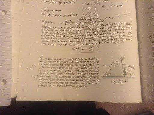

A 20.0-kg block is connected to a 30.0-kg block by a string that passes over a light frictionless pulley. The 30.0-kg block is connected to a spring that has negligible mass and a force constant of 250 N/m. The spring is unstretched when the system is as shown in the figure, and the incline is frictionless. The 20.0-kg block is pulled20.0 cm down the incline (so that the 30.0-kg block is 40.0 cm above the floor) and released from rest. Find the speed of each block when the 30.0-kg block is 20.0 cm above the floor (that is, when the spring is unstretched.
The problem is on page 62 of the document on the attached website along with the diagram. [/B]

When they say "The 20.0-kg block is pulled 20.0 cm down the incline" they mean the vertical height, not the actual length of the ramp. Indeed the length down the ramp is:
##L = \frac{h}{sinθ}##

No, I am not asking that. I am told that the vertical height of the block that is pulled 20 cm at the point where it is pulled away is equal to the vertical height of the equilibrium position of the 30 kg block at equilibrium...
so I have the following... as shown in my photograph.
Why is this the case?

It's just a coincidence, it just means the 20 kg block was at an initial height of 40 cm.

But they do not give me the initial height so logically, I can not even derive the fact that the 20 kg block was at an initial height of 40 cm.
And thus, I can not logically derive what the solutions establish to be fact: that the height of the 20 kg block when it is pulled back equals that of the 30 kg block at equilibrium height.
... so how could I solve the problem without realizing (or making up) this "coincidence?"

I don't see anywhere that says that the block1 when pulled 20cm along the incline ends up at an height of 20cm relative to the horizontal... even if it does, that is just a pure coincidence... it certainly doesn't say that (in relation to the horizontal) its original position had an height of 40cm... that just means his original height was 20+20sen(θ)
PS: i can't read the solutions photograph

What's happening is prob that the thing you are trying to find does not depend on the length of the string (and thus the height of the block) ... so you are free to pick any length you like for that string.
The best thing to do is to pick a length that makes the math simpler for you.
The authors chose the length so that the height of the black on the ramp is the same as the height of the other one when the spring in uncompressed.
You want to see how that changes things - try using a different variable for the height of the block on the ramp.

I just did the problem, you don't even need the height. Let "h" be the initial height of the 20-kg block (m). It's final height will be given by (h + 0.2). The initial height of the 30-kg block (M) is 0.4m (H) and its final height will be 0.2m (H*). Both the initial speeds are zero, the initial displacement of the string is 0.2m (x) and its final displacement is zero. Let their final speeds be "v". By conservation of energy:
mgh + MgH + ½kx2 = mg(h+0.2) + MgH* + ½(m+M)v2
Do you see how the ##mgh## terms cancel? You don't need the height. Just pick the height as being "h" and it will cancel out anyway, or use any arbitrary value but that just complicates the calculation. Hope this helps!

I have a feeling things are getting more and more confused - partly my fault for not reading properly.
The first step in any scientific problem solving is to define the problem - here, that means describing it mathematically.
Start by giving a variable name to every physical thingy mentioned in the problem ... with practise you'll add them in mentally as you read; like this:
A 20.0-kg block ##m## is connected to a 30.0-kg block ##M## by a string that passes over a light frictionless pulley. Block M is connected to a spring that has negligible mass and a force constant ##k## of 250 N/m. The spring is unstretched when the system is as shown in the figure,
... notice that in the diagram, the two blocks are at about the same vertical position ... sort of.
It does not actually matter. Conservation of energy arguments will only care about the change in height, not the absolute height.
... and the incline (angle ##\theta = 40^\circ## to horizontal) is frictionless. Block m is pulled ##x=+20.0##cm down the incline (taking ##x=0## at the position the spring is unstretched and the ##+x## direction is down the ramp) ... so that M is ##y_0=40.0##cm above the floor and released from rest. Find the speed of each block when M is ##y_1=20.0##cm above the floor (that is, when the spring is, again, unstretched.)
... does that help?
Restating: I've used ##x## for the m position downwards along the incline and ##y## for the M height upwards from the floor.
Notice that moving m 20cm down along the incline rises M 20cm above it's initial position... which is correct because the string does not stretch.
... In maths we say: ##\Delta x = \Delta y## Let's call that ##\Delta y = \Delta x = h = 20##cm and just use "h" ... avoids writing out deltas.
So the change in the height of m is ##h\sin\theta## ... the sine of 40deg is not a nice number so I'll just have to leave it.
Here's the physics:
The initial setup stores energy in the spring, and as gravity in M, this energy is released, going to kinetic energy in both blocks but some is used lifting block m.
In maths, that looks like this:
##\qquad \frac{1}{2}kh^2 + Mgh = \frac{1}{2}(M+m)v^2 + mgh\sin\theta##
(I wrote the equation out in the same order as I described the terms above notice?)
... solve for v and you are done.
Notice how there is no need to refer to the absolute height of either block?
Also: no sleight of hand needed.
I don't normally do the problem for you but I think this is an exception - the example, since you've worked on it so much, hopefully will help you focus better in future.
