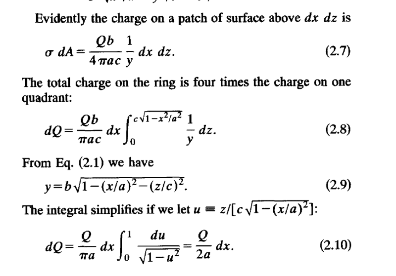

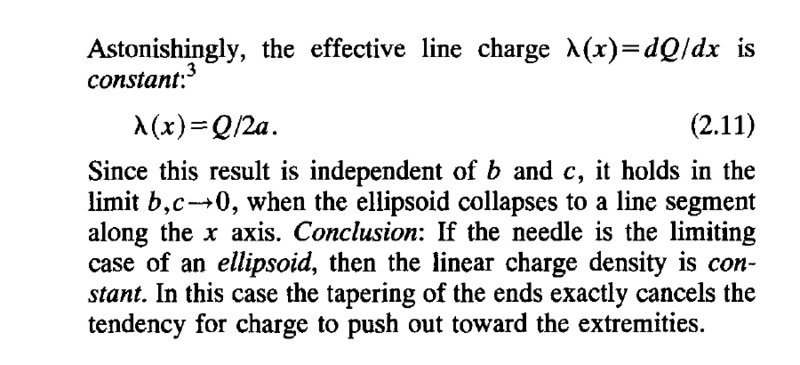

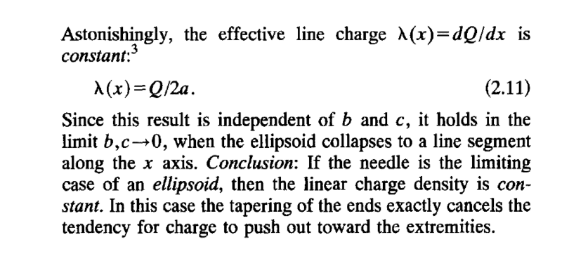

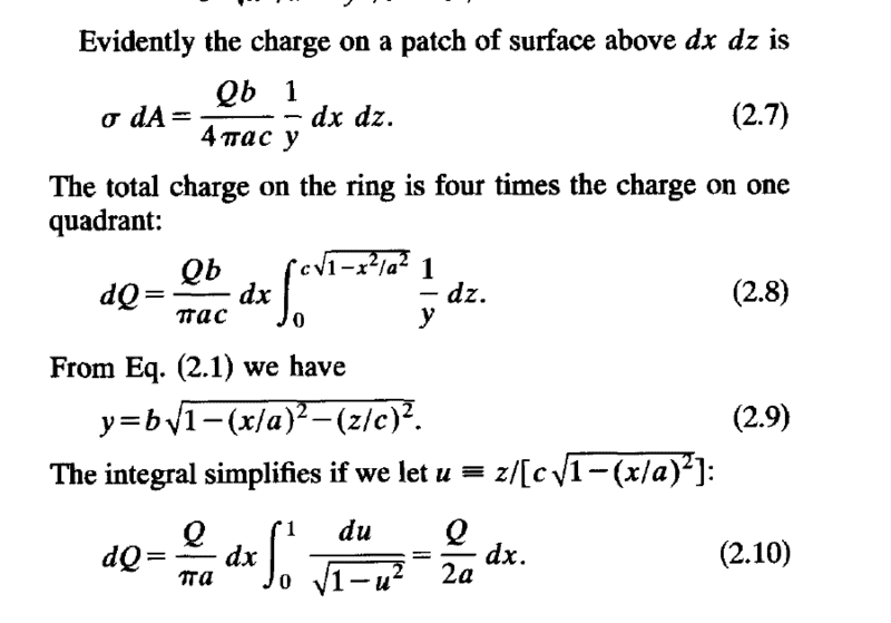

Also, let me clarify that you didn't mean ##\lambda(x)=\frac{dQ}{dx}##. Q is a constant. That Q should be the charge on a ring element, right?
Yes and no. It's easier to explain with the relevant screenshots from the article.
Ok, the abuse of notation is in the original. They define dQ as the charge on a ring element even though Q is a constant, not a function. It would be better to use dq.
Anyway, the more interesting point in post #14 is that the surface charge density function quoted is proportional to the fourth root of the Gaussian curvature, suggesting that curvature is a good guide for charge distribution. But of course that is in the absence of an external field.
Yes, I quoted directly from the original. It is curious that the AJP referee didn't pick it up.

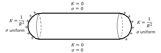

In this paper the following example is given to show that the surface charge density ##\sigma## cannot, in general, be proportional to some power of the curvature ##K##.
Here we have a charged, isolated solid conductor in the shape of a cylinder of radius ##R## with hemispherical caps. The surface of the cylinder has zero curvature and the caps have ##K = \frac 1 {R^2}##. If ##\sigma## were proportional to some power of ##K##, then ##\sigma## would be zero for the cylindrical part and ##\sigma## would be uniform over the caps. But it is not hard to see that this cannot be the case since such a charge distribution would not produce zero electric field throughout the interior of the conductor.
