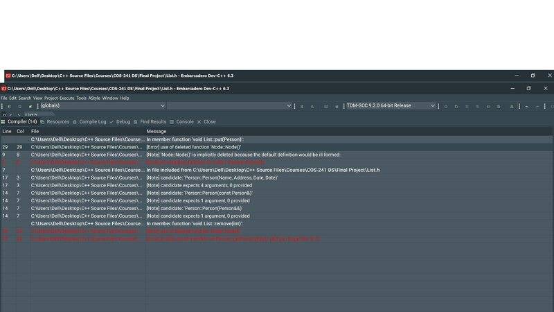

Hi all. I'm working on my final project for a class. The assignment is to have a linked list of personal records, and then do some things with it. Right now I'm working on the linked list class "List.h". I've implemented a Person class "Person.h" as a composition of 3 subclasses "Address.h", "Date.h" and "Name.h". I've attached all of these as text files (I'm not allowed to attach .h files?). I'm able to compile "Address.h", "Date.h", "Name.h" and "Person.h" without any issues. But when I'm trying to compile "List.h" I get some serious compilation errors (attached). The most serious is the one that says my Node struct is implicitly deleted. I need some help on how to solve this without re-doing everything I've already done. Please help.
Your attachment, errors.jpg, is impossible for me to read. I can barely read the lines with white text, but the lines that describe errors are red against a black background, which makes them impossible for me to read. Please copy the contents of the compiler output as text and post it directly, not as an image.
