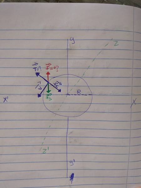

Your answer make's the most sense now (i finished reading about uniform circular motion), but still i can't understand a few things. It's weird, i reached so far learned about motions, forces, Newton's laws and now I've stuck... When a particle move's in a uniform circular motion there is a Centripetal force towards the center.
Question 1:
So if we assume there is no gravity and no other forces applied on the particle, why the particle is not moving towards the center of the circle? So if I name r the axis where the Centripetal force is lying , according to Newton's second law:
∑ƒr = m⋅a ⇔ -ƒc = m ⋅ ( -v^2 / R ) ⇔ fc = m ⋅ ( v^2 / R ) but still i can't understand why the parcicle is moving in a circle and not towords the center. If you can use maths to explain use them.
Question 2:
Let's say i have a rope tied in a particle and I'm spinning it (around a y axis) with my hand. Then the particle is entering a uniform circular motion but also it does not fall to the ground and according to Newton there must be another force with the same magnitude as Fg (weight) in the opposite direction so the particle won't move at all on the y axis. Also if i speed faster and increase the constant speed of the uniform circular motion, the rope will break. Consider the following sketch:
I have a really hard time understanding the cause of these forces. It must F = -Fg so the particle won't fall to the ground or actually won't move to the y-axis at all! There must be also a T force that when it gets high enough it will break the rope. Can someone explain them to me? In this scenario does the T force of the rope being related to the centripetal force?

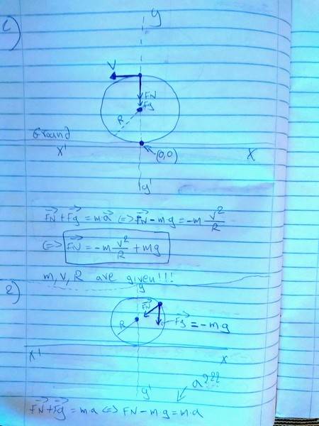

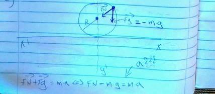

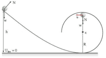

I don't know :sorry: The projectile moves horizontally with a constant velocity but vertically accelerates with a = -g, so it will hit the ground sometime. The spinning particle accelerates all the time and moves in an orbit where it's velocity changes due to the acceleration. Maybe this is the reason? But there is no way to see it with mathematics? I can't just believe words... There's must be a force on the particle except it's weight (Fg) so ∑ƒy = 0 ⇔ -m⋅g + F = 0 ⇔ F = m⋅g and maybe this F has to due something with the Centripetal force. Probably I'm wrong but this the most logical thing to think of.
Or better, take this example:
When the ball is upside down then the forces which are being applied to it are it's weigh, the normal force and the centripetal force so : -ƒc - m⋅g - ƒn = m⋅ay, in other words if the ball does not fall it means ay ≠ 0 and actually ay > 0. According to Newton if there is an ay > 0 (towards the sky) then it must be also a force in the same direction in such a way -ƒc - m⋅g - ƒn + F = 0 <=> F = ƒc + m⋅g + ƒn
Honestly I can't think of something else...

babaliaris said:
So, can you know explain why when you are spinning a particle that is tied in a rope (so the particle is doing a uniform circular motion) why it does not fall to the ground due to it's weight? Also if the speed of the uniform circular motion is big enough it can break the rope, why is that? Also i want to ask something else. In the book: a = v^2 / R (this is the magnitude only) .The ω which u use in the formula above is something else than V? Why the book does not mention something about ω when it should?
You mean spin it in a vertical circle?
At all times the net force must be mv2/r otherwise it won't move in a circle.
At the top "Falling down" requires the radius to reduce. In order for that to happen the centripetal force must be greater than mv2/r.
That will happen if gravity provides too much centripetal force. Another way to say the same thing is... Gravity will provide too much centripetal force (and it will fall) if the velocity is too slow.
Likes babaliaris
Do you understand the difference between velocity and acceleration? Accelerating towards the center is different from moving towards the center.
If it moves in a circle the net force is the centripetal force mv2/r, and the string tension will be whatever is needed for that.
Likes babaliaris

Now I have one more question. Consider the following:
The ball is upside down. The information which i have is:
1) The speed of the ball (lets say that the speed is constant when it starts the circular motion).
2) The mass of the ball.
3) The radius of the circle.
Find the normal force when the ball is upside down.
According to the book, the only things that i can calculate so far (what i learned in physics so far) is ONLY the magnitude of the centripetal force and the weight of the ball. Because in this situation all the forces are parallel to the y-axis and point downwards i can write:
-m⋅g - Fn = m⋅(-u^2 / R)
I know everything except Fn so i can calculate it. Now the book does not showing other situations, maybe because i don't have the knowledge yet, but what if I was analyzing the same problem when the ball was a little more to the right than it is now.
In this situation i know that weight = -m⋅g but I don't know the direction of the acceleration. I can calculate the magnitude but how am i going to find the direction? If i just knew the angle of the centripetal acceleration with the x-axis i could calculate the vector but now can i do something? Or the exercise should give me one more information, perhaps the angle of a with x at that point.
The diagram looks like the initial height, h, is equal to 2R. Is that true? If you know you can figure out the velocity, v, by conservation of the initial energy. Otherwise, you would need to express v as a function of the variable h, v(h).
I don't understand your question about the acceleration of gravity. It is down. When the ball is at the top, the centrifugal acceleration is up and the acceleration of gravity is directly opposite.
In this question, there's no reason to got into non-inertial frames. Just stay in the "lab frame", and there's no centrifugal force (but a centripetal force!).
Sorry guys my mistake, i gave you wrong image.
In the second (i forgot to draw the Velocity vector but the particle is doing uniform circular motion inside a ring), a should have the same direction as Fn (towards the center) but i can only calculate the magnitude of a = v^2 / R and thus i can't find Fn because i don't have enough info about the a vector. (Also in Newtons second law i forgot to put an arrow above a at the bottom of the page and Fn, a and Fn are vectors there)

The vector of centripetal acceleration at a point has always the direction of the radius at that point. So in your scheme, the vector of centripetal acceleration points towards the center, has the same direction as ##\vec{F_N}##.

Yes but i don't know Fn I want to calculate it. Please also consider #30 (because i provided you with the wrong image on #27)

yes I war referring to the second scheme in post #30. The centripetal acceleration there has the same direction as ##\vec{F_N}##. But the total acceleration which is ##\vec{a}=\vec{a}_{tangential}+\vec{a}_{centripetal}## makes an angle with the x-axis which you can calculate, together with the calculation of ##F_N##

I can't understand :cry:
This is where i reached so far:
I know v, m, r and g but not theta. I need theta to calculate the final result...
[Edited]
LoL actually i can find the magnitude of Fn when the particle is upside down and then in the formula above a can replace Fn = |Fn| (cos8 i + sin8 j) and now i have to find (cos8 i + sin8 j) . This is what you meant :-p (8 = theta symbol)

First of all ##\Theta## can be calculated if you know the height h of that point, it will be ##\sin\Theta=\frac{h}{R}##
Your equation is correct at start but at some point it goes wrong. The total acceleration is not only the centripetal acceleration. There is tangential acceleration too. You correctly expanded centripetal acceleration to its i, j components, but you need to add the tangential acceleration components too. So you missing two terms. You also forgot to write g as ##g\vec{j}##.
