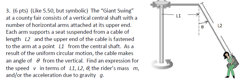

In summary, the homework statement states that radial acceleration is equal to v^2/R, and the attempt at a solution calculates v as sqrt(Rg tanθ).

Anyways, I drew the diagram from a side view (kind of like a circular pendulum) but L1 and the angle is throwing me off. I also drew a free body diagram of the seat at the 3 o'clock position: Tcable (tension or L2?) point towards the center, Tz pointing north, Tr pointing left, and Fg downwards. In the z direction, I have Tz + Fg = 0, so Tcable = mg/cos(theta). In the radial direction, I have Tr = ma(radial) > Tsin(theta) = mv^2/L1(?) so far.
Help will be greatly appreciated.
OK for the tension in the cable. However, you do not have the correct radius of the circle that the rider is moving along.

Is it R = L1+L2x = L1 + L2sin(theta)?
Yes it is. :oldsmile:

Okay so after that part, I plugged in T (from the z direction) and R and I found v = sqrt( (L1+L2sin(theta))*g*tan(theta)). Does that sound about right? But the mass canceled out, how come in the problem they asked for the expression to contain the mass?
Yes.
I don't know. Maybe they didn't want to give away that the mass doesn't matter.

Yeah I didn't think we would need to consider the tangent acceleration in this case.
Right. There's no tangential acceleration in this case since the circular motion is "uniform".
Consider the forces on the rider: there are three.
1. g, acting downward; acceleration g = 9.8 m/s²
2. centifugal force (call it C), acting outward; accleration C = v²/R
3. The force on the cable (call it T), which MUST close the triangle at the hypotenuse, hence T = sqrt (g² + (v²/R)²)
Then θ = arctan (C/g)
Therefore θ = arctan ([v²/R]/g)
tanθ = (v²/R)/g
g tanθ = v²/R
v² = R g tanθ
v = sqrt ( R g tanθ)
Now all you have to do is express r in the terms of the problem (L1, L2, etc) and plug it in ... I think you can figure that out ...
