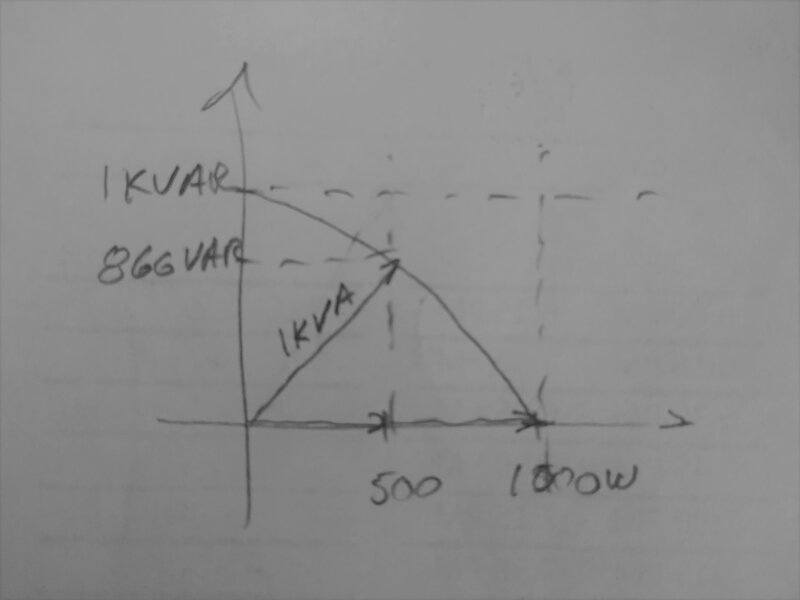

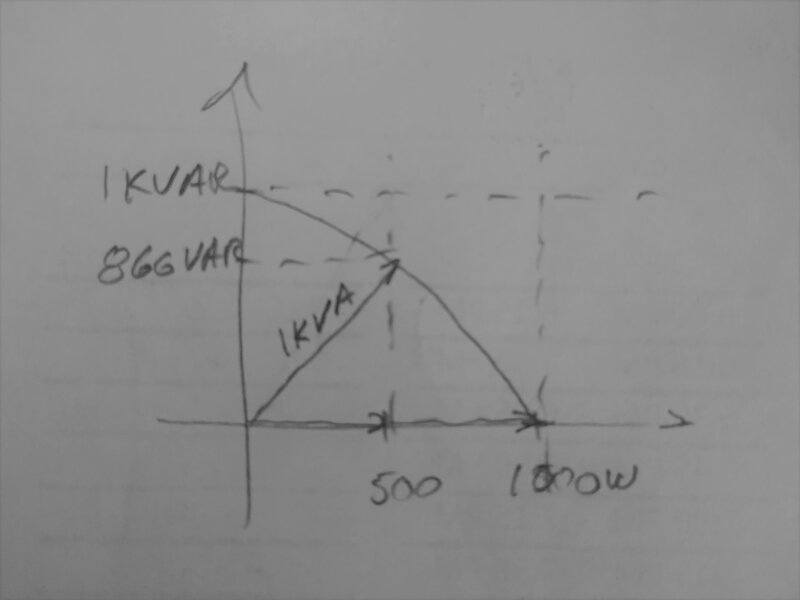

Finally, a crude sketch I drew re. the load spec. You probably understand this, but if not, you'll need to.

I think I understand now. The UPS can't supply 1000W but it can supply 1000VA because 866VAR quickly returns to the UPS. I can see how the size of the battery creates this limitation. Thanks
