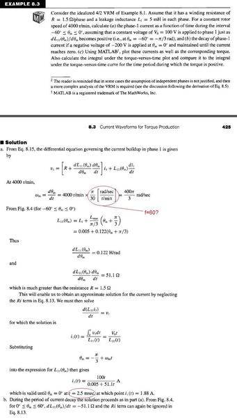

I would like to know how a 4000 r/min is converted to period of t=2.5mSec
Speed of motor = 4000 r/min
Build-up time of current = 2.5msec
Frequency = 60Hz
[itex]\frac{1}{4000}[/itex]=0.25msec not 2.5msec
OR
Assuming it means 4000RPM which is equivalent to 419 rad/sec we obtain:
[itex]\frac{1}{419}[/itex]=2.39msec not 2.5msec
OR
If frequency is 60 Hz, and 1-phase is conducting for 60° we can take period as:
t=[itex]\frac{1}{f}[/itex]=[itex]\frac{1}{60}[/itex]=16.67msec
Conducting for [itex]\frac{1}{3}[/itex] of the cycle (60°), t = 5.55msec
Where have I made a mistake ?

If T = 2.5ms, then the frequency is 400Hz. There is something wrong with your initial statement. Where did it come from?
It comes from "Electric Machinery" by Mr. Fitzgerald
At the very bottom of the screen a period, T, of build-up of current is defined as 2.5msec.
For N = 4000 rpm, then n = 4000/60 rps = 66.67 rev/s
1 rev = 2 pi radians
omega = 2 pi * 66.67 = 133.33 pi radians/s
T = 1/omega = .0024 s = 2.4 msec
Disregard previous post:
For N = 4000 rpm, then frequency f = 4000 / 60 = 66.67 cycles / s
T = 1/f = 0.015 s = 1.5 msec
All right, thank you very much. I will use the very first formula, still it isn't exact 2.5msec.
The solution gives the expression:
##\theta_m = -\frac{\pi}{3} + \omega_m t##
Plug in your value for ##\omega_m## and solve for t that makes ##\theta_m = 0##.

This is the final correct solution.
Thanks, thread can be now closed.
