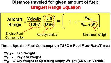

Given Thrust-specific fuel consumption cT=0.5279lb/lbf*h... as other units in the question are in SI unit, I have to convert it to (N/s)/N first...
1 lbf = 4.448 N
1 lbm = 0.4536 kg
Thrust-specific fuel consumption = weight of fuel burned per unit time (N/s) per unit thrust (N)
cT=0.5279lb/lbf*h= (0.5279lb/lbf*h)* (4.448 N/lbf) / (0.4536 kg/lbm) / (3600s/h) = 1.49e-5 kgN-1s-1
which the unit of my answer stands for mass per force per time (kg/Ns) instead of force per time per force(N/Ns)...
where in the unit conversion have i done wrong? thank you very much!

when i use Breguet Range Equation (see the picture below), should i use cT with unit of N/Ns or kg/Ns?
thanks.
Lift/drag and the log term are both dimensionless .
Range = a dimensionless constant x Velocity/TSFC
Dimensionally : L = L T-1 / Dimensions of TSFC
(Edit) or dimensions of TSFC = T-1
thanks.
That needs N/(Ns).

So I have to multiply g in order to calculate range, right? Let me type my unit conversion here again:
$$\ cT=\frac{0.5279lb}{lbf\cdot h}=\frac{(0.5279lb}{lbf\cdot h})\cdot(\frac{4.448N}{lbf})\cdot(\frac{0.4536kg}{lbm})^{-1}\cdot\left(\frac{3600s}{h}\right)^{-1}$$
$$\ =1.49e-5\ kgN^{-1}s^{-1}\ \cdot\frac{9.81m}{s^2}=1.46e-4\ \frac{N}{Ns}$$
Is it correct and be ready to substitute it into Breguet Range Equation? Thank you so much!
