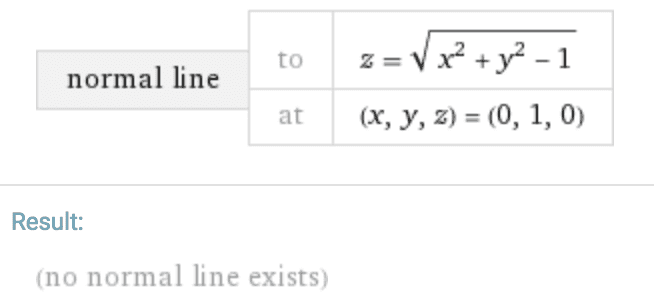

My problem is that I am getting an indeterminate value for the partial derivative w.r.t y evaluated at (0,1,0). I'm struggling to see where I have gone wrong, if anyone could help point out my mistake it would be greatly appreciated :)
I have also attached a wolfram alpha screenshot in relation to my second attempt's method, does this second method only work for some scalars?

It's best to use the formula ##\nabla \phi = \langle \phi_x,\phi_y, \phi_z \rangle##. Your answer is correct. The problem is probably that the surface has a vertical tangent plane at the point whose normal is in the y direction. z isn't a function of x and y at that point, but the surface still has a unit normal.

Ah okay thank you for that, I'll stick to the grad method
