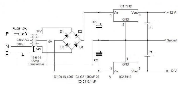

OK here's one example of a split rail PSU
depending on your overall circuit, you may be able to use a +5V 0V -5V supply
NOTE ... I don't know where your are in the world, nor your mains voltage, use the appropriate transformer. Also if you only need a + and - 5V the transformer output could also be lower say 9-0-9VAC
