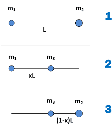

With a small sketch things become easier:
In number 1 you have $$
F={G\,m_1m_2\over L^2}
$$so in number 2 you want $$
{G\,m_1m_3\over x^2L^2}={G\,m_1m_2\over L^2}\quad\Rightarrow \quad
m_2 = {m_3\over x^2} \quad \Rightarrow \quad m_1 = {m_3\over 2x^2}
$$Then in number 3 you require $$
{G\,m_2m_3\over (1-x^2)L^2} = {G\,m_1m_2\over L^2}\quad\Rightarrow \quad m_1 = {m_3\over (1-x)^2}
$$this way it's easy to see your
was still correct, as @TSny replied.
