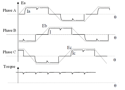

A pseudo similar thing happens in BLDC (trapezoidal BEMF) machines. At a sector change, a winding has to go from full phase current to zero current. The winding has inductance, and the energy stored in this inductance due to the previously flowing phase current has to be dissipated to bring the coil current to zero.
Note how Ia for example goes from full phase current to zero in essentially a step.
Its important to note that the induced voltage from the stator inductance experiencing a current change is distinctly different from the induced voltage of the moving rotor, more or less analogous to leakage inductance in a transformer.
This energy is typically dissipated in the body diodes of the switching bridge. I'm not sure if its practical to attempt to recover this energy!

Interestingly in a sine driven poly phase machine stator inductance is also charged and discharged at every half electrical cycle, but due to the switching architecture this energy is cycled to and from the bus, not burned up in a diode.
@essenmein Isn't it also easier to recover this energy because the waveform is sine and the current change in time is much slower than it would be for a square waveform?

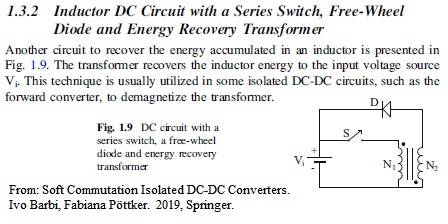

There is a parallel here where the overlapping of the windings in a motor can make a transformer. The question comes as to how the energy can get back through the driver to the supply, or to the currently powered winding.
Recovery is perhaps the wrong word, the architecture of the drive and machine basically dictate whether or not the stator inductance constitutes an energy loss and phase angle (BLDC) or a voltage loss and phase angle (most other machines).
Its more to do with the switch pattern. In BLDC when a phase is active, ie voltage is applied to this phase coil via PWM to generate phase current, then when a sector changes, this PWM pattern is abruptly applied to a different set of switches (and therefore phases), the current in the previously active phase dissipates by freewheeling via what ever diode it feels like. BLDC machines are essentially replacing the commutator and brushes with hall sensors and a 3ph bridge, vs a "real" 3 phase machine which runs with more or less continuous phase current. I'm not sure if its reasonable to say the phase current discontinuity in BDLC is the cause here...
In a sine PWM inverter all the phases always have some PWM applied, so when the inductance is being charged with increasing current, the inverter bucks current into the coil, when this current has to reduce, the inverter breifly boosts this energy difference back to the bus, in reality this looks like a little additional phase angle on the applied voltage vs the current, and this phase angle slightly changes the angle of the energy flow in and out. Since this inductance is in series with the machine, another way to look at it is the voltage vector iωL is produced at 90deg to the phase current, this voltage amplitude is speed dependent (ω = rad/s) and current dependent (i) and reduces the maximum useful voltage applied to the machine, especially as speed increases (assuming your inverter bus voltage is fixed).
Baluncore said:
There is a parallel here where the overlapping of the windings in a motor can make a transformer. The question comes as to how the energy can get back through the driver to the supply, or to the currently powered winding.View attachment 259577
This transformer action is a PITA, most machine guys I've worked with only think in terms of machine fundamental, not the 10-20kHz voltage actually applied. So now do some distributed windings where coils from different phase share slots, voila, one inverter phase interferes with the PWM applied to the other at the inverter frequency not the machine frequency, many control problems as a result...
