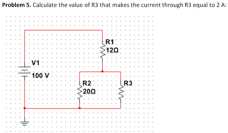

Hey guys, I have tried and tried to find a start to this problem with no success. My book may have the answer but unfortunately I must be not realizing it. So hopefully I just need a different perspective. Typically I would find the equivalent resistance of the circuit and then begin to calculate current and voltage drop across each resistor. In this situation I would find the resistance of the parallel resistors R2 and R3 by using the reciprocal of the sum of the reciprocals of the resistors equation, then add them to the series resistor R1. But because I do not have the value of R3 I can't do that. And because I don't have the current in the circuit I can't find the voltage drops to work my way around the circuit. Does anyone know how to begin this problem? Any hints would be greatly appreciated.
Ohm's Law, resistance in parallel circuits, and resistance in series circuits.
I don't know where to start on this one because my typical starting point is finding the equivalent resistance.

There are 3 unknowns: ##R_3##, ##I_1##, ##I_2##, where ##I_1## is the current flowing through resistor ##R_1##, ##I_2## is the current flowing through resistor ##R_2##. You are given that you want ##I_3 = 2A## (the flow through resister ##R_3##). So if you can come up with 3 equations relating those quantities to the known quantities ##I_3##, ##R_1##, ##R_2##, and ##V_1##, then you can solve the problem.
Hint: Apply nodal analysis where the resistors all come together.

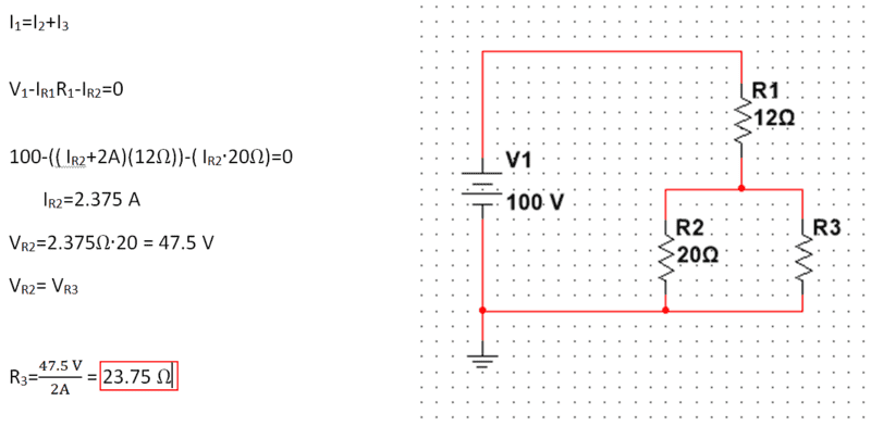

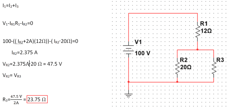

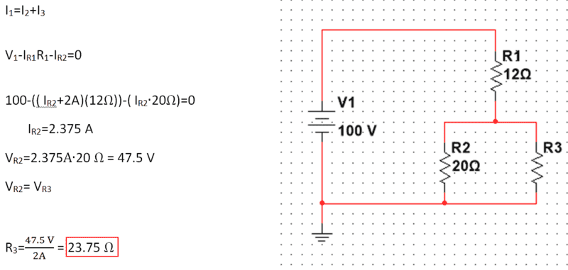

Ok, thank you to everybody that offered tips to help me solve this problem. I do not know why but no matter which way I looked at it I could not wrap my head around it. Now that stevendaryl basically had to hold my hand for me to FINALLY see it, I got it figured out. Thank you very much stevendaryl for making me think it through and give me a different perspective to look at it through. Here is how I finally got it:
Thanks again to everyone that offered their assistance!

Since the OP has arrived at a correct solution though his efforts, I thought I'd present two alternative methods based on the hints that I gave earlier (Nodal analysis and Thevenin Equivalents). I understand that the OP may not have covered these techniques yet in their course, but for those who have (or who have read ahead) it might prove useful to see that there are often multiple ways to analyze a circuit and that some techniques can turn what would otherwise involve a fair bit of algebra involving simultaneous equations into something relatively straightforward.
First Method: Nodal Analysis
Consider the node equation for the node labeled ##V_x## in the following figure:
Summing the currents leaving the node we have:
##\frac{V_x - 100}{12} +\frac{V_x}{20} + \frac{V_x}{R3} = 0##
Now we know that the current through ##R3## is a given 2 A, so the equation becomes:
##\frac{V_x - 100}{12} +\frac{V_x}{20} + 2 = 0##
so that
##V_x = \frac{95}{2}~V ## or 47.5 V.
We now know the potential across ##R3## as well as the current through it, so by Ohm's law:
##R3 = \frac{95/2}{2} = \frac{95}{4}~Ω = 23.75~Ω##
Second Method: Thevenin Equivalent
Taking ##R3## to be the "load" on the rest of the network, we remove that load and find the Thevenin Equivalent for the remaining source and resistor network:
##R_{th} = \frac{12⋅20}{12 + 20} = \frac{15}{2} = 7.5~Ω ##
##V_{th} = 100 \frac{20}{12 + 20} = \frac{125}{2} = 62.5~V##
So the circuit can be reduced to:
Since the current in this series circuit is by inspection 2 A, we can invoke Ohm's law:
##I = \frac{V_{th}}{R_{th} + R3}~~~~## or numerically, ##~~~~2 = \frac{62.5}{7.5 + R3}##
Solving for R3:
##R3 = \frac{1}{2} 62.5 - 7.5 = 23.5~Ω##
Edit: Corrected a couple of minor typo's in the verbiage. The equations are untouched.
