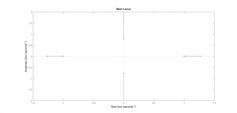

To simplify, I have a system whose transfer function looks like this:
G = (s^2-1) / (s^4-s^2-1)
It's unstable and I have to find a way to stabilize it using PID controller and/or lead/lag compensators.
So far I tried a simple PID controller (Kp + Ki/s + Kd*s), a PID controller with low pass filter (Kp + Ki/s + Kd*s/(1+N*Kd*s), a PID controller with multiple derivatives and integrators (P*I^m*D^n) but no luck.
I'm using MATLAB to solve it.

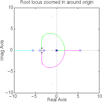

Root locus attached.
Could you give me any hints?

Please sketch a root locus and attach it. I would like to see it.

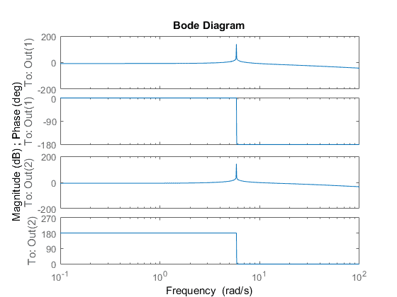

another hint.
take a look at a bode plot (if you have MATLAB this should be easy)
once you look at the bode plot that might help you understand what you need to do to stabilize your system

donpacino,
That's a bode diagram (I have 2 outputs). What conclusions should I make from that? Sorry, I'm all new to this.
Your plant has the transfer function: G = (s^2-1) / (s^4-s^2-1)
In #2 I have suggested a transfer function like: H = K*(s+a)(s+b)(s+c) / ( ( s+d)(s+e)(s+f) )
The two transfer functions are connected in series, so the overall transfer function as for the open loop will be: GH(s) = G(s) * H(s)
It is tempting to place a zero/pole pair in H(s) matching the righthand pole/zero pair in G(s), to cancel/get rid of them, but that doesn't work in practice because you cannot hit them exactly. Thus you must do as stated in #2:

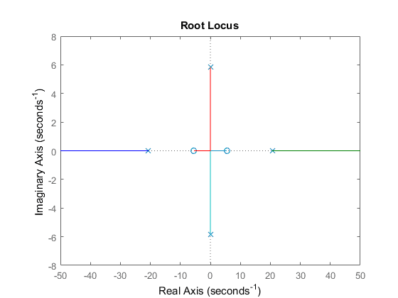

Now, calculate the characteristic equation (Mason's rule) as for the closed loop transfer function, plot the root locus by varying K from 0 to ?. You should get something like this ( just an example with only 3 curves):
At the calculated K-value, you should see all the 7 curves passing the desired locations, left to the imaginary axis ( stable area ).
