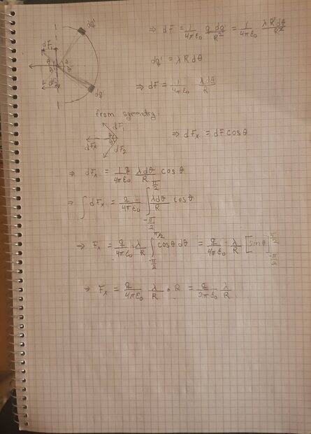

  • #68
regarding to b) I think I already solved it could you please take a look of it
Edit: I missed a "q" in the third expression
Likes PhDeezNutz and bob012345
  • #69
Looks correct.
  • #70
Thank you everyone that helped me in this problem I finally understood ☺️☺️☺️☺️
  • Love
