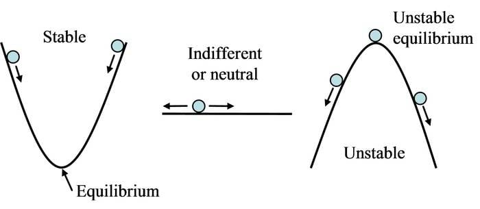

If ##\beta < 0##, then the solution decreases exponentially. Why is this not an unstable solution also?
Because then any deviation from the constant solution disappears really quickly. The situation is similar to comparing these images:
and assuming that there's friction between the sphere and the convex/concave surface. The constant solution is similar to the equilibrium situation where the sphere is positioned exactly on the top/bottom of the hill.
I don't quite understand. How does the deviation disappear? It's still there, right?
After all, an exponential solution with negative exponent takes the initial value of ##\phi## exponentially (i.e. takes forever) to zero, right?
It's the same thing as the difference between positive and negative feedback in systems theory: http://serc.carleton.edu/introgeo/models/loops.html
In the positive feedback case, a small deviation from equilibrium blows up uncontrollably, like the number of grains in the "wheat and chessboard problem".
