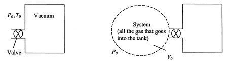

There are 2 parts to this. First, to use thermodynamics to get the final conditions in the tank. Second, to analyze the fluid flow aspect of the problem. You certainly won't be able to do the second part without first being able to do the first part. So, my advice is to first determine the final conditions in the tank.
Assume the system is adiabatic so that you don't need to deal with heat transfer between the gas and the tank. Let u be the internal energy per mole of the gas in the tank in the final state, and let ##u_0## be the internal energy per mole of the gas in the initial state. Let ##n_0## be the number of moles of gas in the tank in the initial state and let ##\Delta n## be the number of moles of gas entering the tank between the initial and final states. Let ##h_{in}## be the enthalpy per unit mass of gas entering the tank. In terms of only these parameters, please write down the open system (control volume) version of the first law of thermodynamics applicable to the change in this system between the initial and final states.
Thanks for the reply. I'm guessing that this diagram is a correct representation of the system?

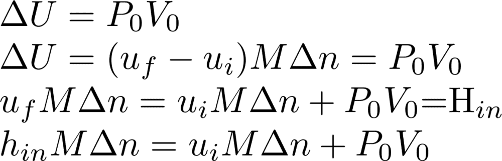

Based on the first law of thermodynamics you get
243726

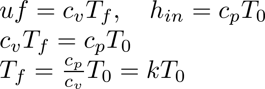

Since you are saying that I should assume that it is adiabatic, that means that there is no heat transfer into the system so Q=0. Since there is no kinetic or potential energy of the final state, all that is left is internal energy. Finally, there is work done on the system that is equal to the pressure times the volume. Thus, the equation should simplify down to:
243734
Where M is the molar mass of air

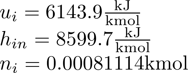

If I use the equations for internal energy of air and enthalpy of air and plug them in I would get
243759
If I plug in the values I get the final temp. of the system equal to 413.5 Kelvin which is 283.73°F and that seems unlikely which leads me to believe that I made a mistake.

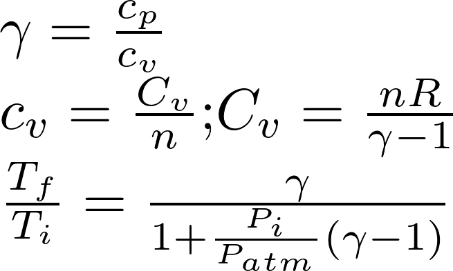

Here's my starting analysis. Please see if it makes sense to you based on the open-system version of the 1st law of thermodynamics: $$(n_i+\Delta n)u_f-u_in_i=\Delta nh_{in}$$where $$u_f=u_i+C_v(T_f-T_i)$$and, since the temperature outside is equal to the initial temperature inside,$$h_{in}=u_i+P_{atm}v_{atm}=u_i+RT_i$$
I was mistaken about something. This problem doesn't only have to be treated as an open-system problem. It can also be treated using the closed system version of the 1st law. Here is the development using that approach.
Again, let ##n_i## represent the initial number of moles in the tank, and let ##\Delta n## again represent the number of moles forced into the tank by the outside atmosphere. Then, our closed system will be comprised of these ##n_i+\Delta n## moles. The change in internal energy of these moles of air is ##(n_i+\Delta n)(u_f-u_i)##. The work done by this combined system on the surrounding air is ##W=p_{atm}\Delta V=-\Delta n RT_i##. So, from the closed system version of the first law, we have: $$(n_i+\Delta n)(u_f-u_i)=-W=\Delta nRT_i$$This is the same result as that produced by the open system analysis of post #4.
Basically, your analysis was pretty close to correct to begin with. You just forgot to take into account the gas that was originally present in the tank.
When applying this analysis to your problem, I get a final temperature of 198 F. See if you can get ##T_f/T_i## in terms of ##\gamma## and ##p_i/p_{atm}## and then see if you can duplicate this result.

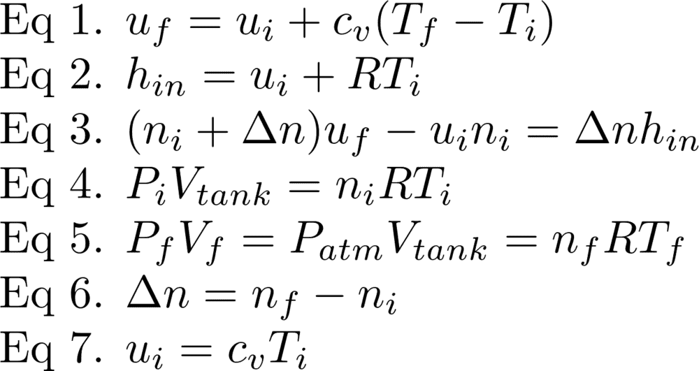

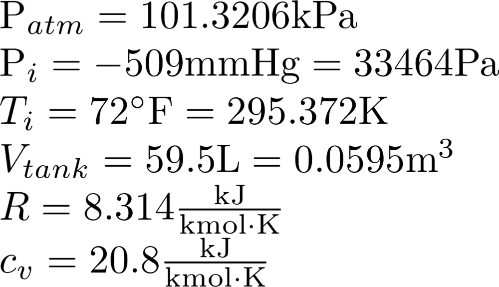

So here are my equations
243900
And here are the initial conditions
243899

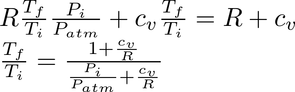

You can solve Eq. 2,4,7 outright getting:

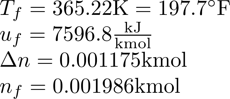

243901
I then solve for n in equation 5. Plug that into equation 6. I then plug equation 6 into equation 3 and also plug equation 1 into equation 3 and then solve for the final temperature. I get
243905
Which is the same as what you got. Thus, that means that the temperature jumped over 100F?!

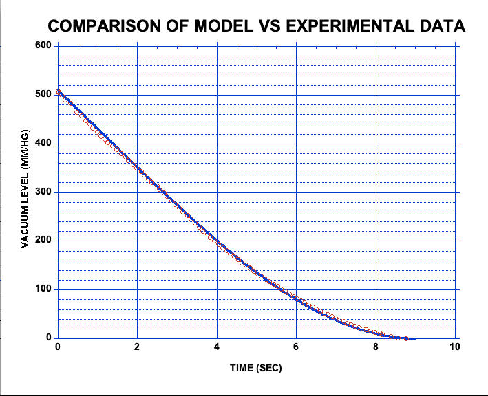

Anyway, what would be next for calculating the transient information? Based on the experimental data, I got the fill time to be exactly 8.76 seconds and found that data followed the curve
243906
with an average relative error of 0.3622 %
Where y is the pressure in the tank and x is the time.

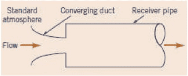

I just discovered something very interesting. I opened up my Fundamentals of Fluid Mechanics Seventh Edition textbook from college, turned to the last chapter about compressible flow and low and behold, all the equations that I just listed out were there. 🤦‍♂️ That would have helped significantly and saved me a lot of time if I found it earlier. However, further in the chapter, I did find an example problem in the textbook called Isentropic Flow in a Converging Duct. It states:
A converging duct passes air steadily from standard atmospheric conditions to a receiver pipe as illustrated:
243929
The throat (minimum) flow cross-sectional area of the converging duct is 1e-4 m^2. The receiver is (a) 80 kPa (abs), (b) 40 kPa (abs)
They then walk you through the problem. The really interesting part comes from when it says:
If p_receiver < p*, then p_throat = p* and the flow is choked. Where:
243932
Thus, the flow at the throat is traveling at the speed of sound!
Now, obviously, my problem isn't steady flow. However, the cross section of the orifice in my experiment is 3.318e-5 m^2 and the tank's initial pressure is 33.4 kPa (abs), both of which are smaller than the example problem. Does that mean that the initial speed of the air in my experiment was going at the speed of sound?! If so, that's awesome! That would also mean that the initial pressure values that I read were not correct because you can't measure the pressure of a system upstream of a flow that is traveling at the speed of sound. Would you concur with this evaluation?

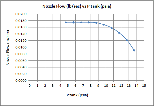

The smaller the hole, the more frictional dissipation. By assuming that the gas enters the tank with the same enthalpy as outside, we have been saying that frictional dissipation is the main contributor to the pressure decrease through the hole. We can check afterwards to ascertain whether or not the flow would become sonic and choke. I don't think this will be the case.
Your data suggests that, at least initially, the flow might have been close to sonic. Just take the number of moles, divide by the initial molar volume (minimum), the total time, and the hole area. This comes out to about 200 m/s. This doesn't take into account for the fact that the initial molar flow rate was higher than the average molar flow rate.
Chestermiller said:
Can you please post a graph of this? Thanks.
I used this website:
https://planetcalc.com/5992/
It's a very quick way to run different regressions to determine the best one.
X-Data:
Code:
0.013020875 0.108853125 0.17968575 0.308333375 0.475516125 0.592181625 0.688014 0.79634625 0.867178875 0.983844375 1.067176875 1.183842375 1.254675 1.375507125 1.4713395 1.588005 1.69633725 1.775503125 1.89633525 1.967167875 2.100499875 2.1713325 2.275498125 2.358830625 2.500495875 2.54632875 2.667160875 2.74632675 2.867158875 2.9379915 3.054657 3.1379895 3.258821625 3.350487375 3.44631975 3.554652 3.64631775 3.75465 3.8379825 3.942148125 4.0379805 4.133812875 4.242145125 4.333810875 4.42964325 4.5379755 4.62964125 4.72964025 4.8379725 4.92963825 5.025470625 5.121303 5.225468625 5.321301 5.42963325 5.521299 5.61296475 5.725463625 5.817129375 5.925461625 6.008794125 6.11295975 6.208792125 6.3046245 6.40962275 6.50120525 6.59828775 6.70637025 6.796875125 6.89537425 6.98970675 7.08678925 7.18937175 7.28645425 7.38078675 7.47236925 7.58045175 7.67753425 7.76911675 7.86619925 7.97428175 8.102314625 8.160647375 8.385645125 8.55385275 8.766350625
Y-Data:
Code:
33997.20395 34930.46053 35997.03947 36930.29605 39463.42105 40396.67763 41596.57895 42663.15789 43729.73684 44929.63816 45996.21711 46796.15132 47596.08553 48662.66447 49462.59868 50662.5 51595.75658 52529.01316 53595.59211 54662.17105 55595.42763 56528.68421 57595.26316 58528.51974 59595.09868 60528.35526 61461.61184 62394.86842 63594.76974 64528.02632 65594.60526 66661.18421 67594.44079 68527.69737 69594.27632 70794.17763 71860.75658 72660.69079 73727.26974 74660.52632 75460.46053 76393.71711 77193.65132 78126.90789 78926.84211 79726.77632 80526.71053 81193.32237 81993.25658 82793.19079 83593.125 84259.73684 85059.67105 85726.28289 86392.89474 87059.50658 87726.11842 88392.73026 89059.34211 89859.27632 90392.56579 90925.85526 91592.46711 92125.75658 92659.04605 93192.33553 93858.94737 94258.91447 94792.20395 95325.49342 95725.46053 96258.75 96658.71711 97192.00658 97458.65132 97858.61842 98258.58553 98658.55263 98925.19737 99325.16447 99591.80921 99858.45395 100258.4211 100658.3882 101058.3553 101325
Attached is the raw data in excel format for your convenience.
  • Vacuum Tank Experiment.xlsx

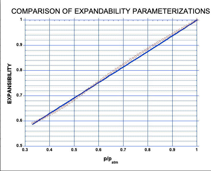

I like the pressure-difference vs flow relationship presented in this reference better than the one I proposed in post #16, because the effect of compressibility is more fundamentally based. So I recommend switching to it:
$$\dot{m}=C\epsilon A \sqrt{2\rho_{atm}(p_{atm}-p)}\tag{1}$$
where C is the discharge coefficient of the hole and ##\epsilon## is the correction factor for compressibility: $$\epsilon=0.649+0.351\left(\frac{p}{p_{atm}}\right)^{1/\gamma}\tag{2}$$
This relationship can readily be manipulated into a form very similar to the one I proposed.
Your experimental data on the initial rate of decrease of pressure can be used to determine the value for the discharge coefficient C. I calculate a value of 0.48. What do you obtain?

With respect to the above, I have created the below graph for the filling mass flow vs tank pressure for tank pressures from 4.7 to 13.7 psia (the same graph with more refined values can be provided if desired) that illustrates the two conditions, sonic and subsonic nozzle flow that exist for this problem. This graph does not necessarily reflect the actual rates because, for lack of a confirmed value, it is for a nozzle coefficient of "1.0" (but I can revise it for any other coefficient you might desire). Because of the wide range of pressure differentials during the filling both of the above flow conditions that have substantially different profiles exist during the filling and make developing an accurate single curve fitting difficult. In such cases, for programming purposes, I have resorted to breaking the total curve into separate sonic and subsonic curves using the sonic pressure ratio for the gas as an (if,then,or value) function to select the appropriate curve for for a curve fitting for each flow region.
The excel program I use to obtain the graph's values calculates the mass flow for a Pin air of 14.7 psia & 70°F (R critical = .5283) for the values for each tank pressure point and I used those to develop the shown graph (the program actually calculates values for both regions simultaneously and then uses the (if, then,or) function to present a final value selected.
P tank (psia)lb/sec (lb/sec)
4.7​
0.0175​
5.7​
0.0175​
6.7​
0.0175​
7.7​
0.0175​
8.7​
0.0174​
9.7​
0.0168​
10.7​
0.0159​
11.7​
0.0144​
12.7​
0.0123​
13.7​
0.0091​

I would have done this somewhat differently. From our previous development, you have an equation for the mass flow rate in terms of the rate of change of pressure given by $$\dot{m}=\frac{V_TM}{\gamma RT_i}\frac{dp}{dt}$$ So you could substitute this for the mass flow rate in your flow equation and obtain a differential equation entirely in terms of the pressure, with the time derivative of pressure directly expressed as a function of pressure itself. You could then solve this ordinary differential equation numerically (say by forward Euler) to obtain the pressure as a function of time. You could then compare the entire curve with the experimental data.
You have split the behavior into two parts, representing the initial sonic part and the subsequent sub-sonic part. And you have used the theoretical equations in Wiki for determining the mass flow rate. I prefer working with the ISO standards recommendations (approximations) because they have extensively been applied and validated in practice. I also like the idea of using a continuous description of the compression parameter so that no judgments need to be made about when to switch from one representation to the other.
What I'm going to do is use Eqn. 1 and 2 in post #21 to solve for the pressure in your experiment as a function of time. I have already started doing this using a value of 0.48 for C, which was based on the initial rate of pressure decline from your data, together with a value for ##\epsilon## of 0.8 using Eqn. 2 for the initial conditions. This, of course, worked well at predicting the pressure variation at short times (< 2 seconds), but it deviated from the data a bit at larger times, and ended up predicting a filling time of about 11 seconds (compared to the observed value of about 9 seconds). My next iteration will be to use your value of 0.67 for C, and to adjust ##\epsilon## so it again matches the rate of pressure decrease at short times. To do this, I will have to modify the parameterization of the compression factor ##\epsilon## so that it matches properly at the two end points. The form I will be using will be:
$$\epsilon=\left[0.649+0.351\left(\frac{p}{p_{atm}}\right)^{1/\gamma}\right]^{2.5}\tag{2-mod}$$
Together with C = 0.67, this parameterization will match your "choked flow" mass flow rate at short times and will match the condition that, as p approaches atmospheric, ##\epsilon## approaches unity. With this change, I am confident that the model will do a much better job of matching the entire pressure profile as well as the fill time.
I'll keep you posted.
Chet
I completed the model calculation I described in my previous post. The new calculation again matches the rate of pressure decline and choke mass flow rate at short times, but also matches the observed fill time of about 9 seconds. I'll present comparison graphs later.
Chet
  • #31
The circles are the experimental data. The line is the model calculation as I described in my most recent posts.
