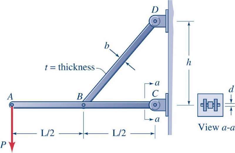

A boom AC is supported by a rectangular steel bar BD, and it is attached to a bracket at C by a high-strength steel pin. Assume that the pin at B is adequate to sustain the loading applied to it, and that the design critical components are the bar BD and the pin at C. The factor of safety against the failure of BD by yielding in uniaxial tension is 3.0. The factor of safety against a shear failure of the pin at C is 3.3. Determine the required:
a) Thickness, t of the rectangular bar BD, whose width is b; and, b) Diameter, d, of the pin at C.
known data
P = 10 kN,
L = 3 m,
h = 2 m
Bar BD: b = 25 mm,
shear stress = 250 MPa
Pin C: = 400 MPa
