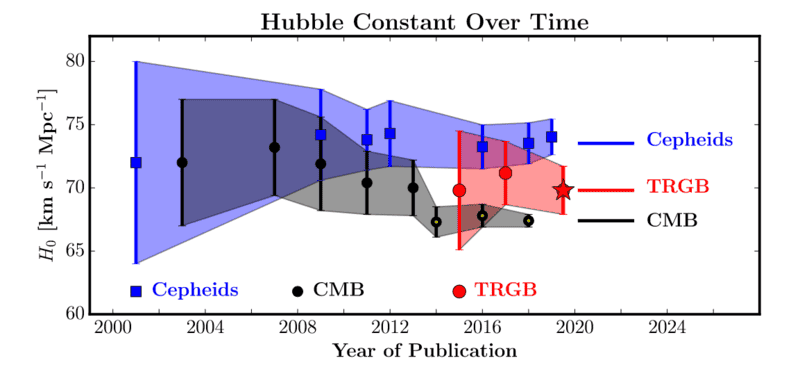

That's quite a bit northwards of previous TRGB determinations:
(Freedman et al. 2019; fig.17)
