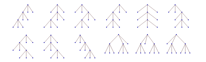

how to find upper bound height and lower bound height of 3-ary ordered tree that have leaves of 101? ( the tree don't have to be complete tree, but have to be have 3 children)
$$m^h \ge 101=3^h \ge 101$$
$$log \, m^h \ge 101=3^h \ge 101$$
$$h \ge 5$$
but how to know upper bound and lower bound of leaves?
edit: leaves at the last height is 3
$$3+2(n-1) \ge 101= 3+2n-2 \ge 101 = 2n-1 \ge 101= 2n \ge 100 = n \ge 50 $$
is this right?

Can you give an example? What does it mean: not necessarily complete, but three children? At each level, always, once?
Upper bounds are easy to find: you only have to give an example.
Lower bounds are the difficult part: you have to find a height which is provable needed at least. For this we need a very accurate definition on all properties of the tree.

this is the tree not necessary complete but have 3 children

This could mean: At least three nodes on the lowest level, at least one node with three children, or at least one node with three children at each level. Which is true? And what is ##101##? Nodes in total? You have to be exact. Otherwise it is guesswork what we are doing here.

the tree always have node with three children since it is ternary tree like in graph so it cannot have one child or two child
total leaves=101 not nodes

My confusion is not the common definitions, it comes from your conditions. The 3 children condition is simply not accurate enough to work with. At most is clear from ternary, but how many at least is totally unclear to me.

what do you mean by at least? there is no at least, all node have 3 children . as you can see in the link i provide ,
"In graph theory, an m-ary tree (also known as k-ary or k-way tree) is a rooted tree in which each node has no more than m children. A binary tree is the special case where m = 2, and a ternary tree is another case with m = 3 that limits its children to three. "
is it clear enough ?

If there are n nodes, how many edges are there?
How many vertices?
How many leaves?
How quickly (adding fewest nodes) can you reach a given height? How slowly?

I know that to get the minimum height, the tree has timo be complete 3ary tree,where in each level is full right(?)
The complete tree is of minimal height for at least ##101## leaves. Now are there other trees with lower upper bounds? Are there trees with greater lower bounds?
