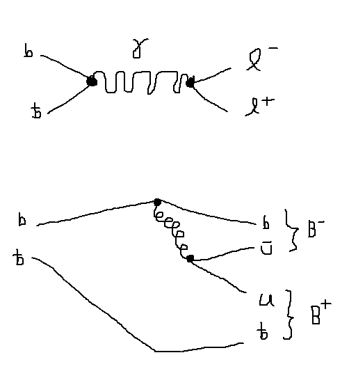

Part(a)[/B]
Feynman diagrams are given by
Decay to other ##q \bar q## is cabbibo suppressed by ##\sin \theta_c##.
I'm not sure why the width at 4s is particularly wide.

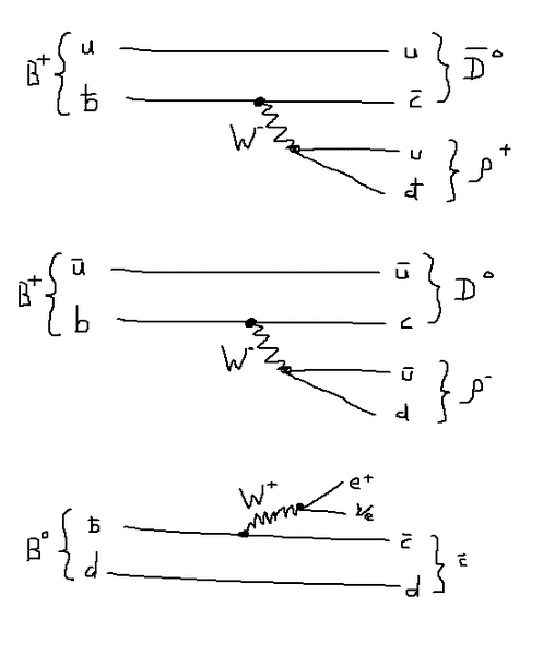

Part(b)
Weak interactions. Only weak interactions are possible as the flavour is not conserved. Feynman diagrams are shown below:
Why should it?
There is no decay to ##q \bar q## present in your diagrams.
Same comment as usual: check the particle masses to find possible decays. Which interactions are responsible for them?
Right (but the W sign is odd, one B+ should be B- and the D- label are missing).

mfb said:
Why should it?
There is no decay to ##qq¯q \bar q## present in your diagrams.
True. Sorry I was thinking of inter-generation mixing in weak interactions. I think it is suppressed because strong interactions are preferred over weak ##(Z^0)## and EM ##(\gamma)## interactions. If that's the case, then wouldn't EM/weak production of lepton/anti-lepton pairs be suppressed as well?
I think something happened between ##3s## and ##4s## state, something extra must have been produced between ##10.355GeV## and ##10.580 GeV##. I think it's the production of ##B^{+}B^{-}## pair of bosons.
That's right. Thanks for pointing that out.
What is suppressed relative to what now?
And ##B^0 \bar B^0##, right.

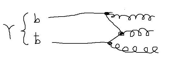

1s and 4s decays via strong interaction while the B mesons that only decay via weak interactions (as flavour is not conserved) and that corresponds to longer lifetimes. Stronger the interaction, the shorter the lifetime.
How does the 1s decay via strong interaction look like? That is exactly the qqbar decay that is missing here so far. And it is suppressed in the same way the charmonium you had a while ago rarely decays via the strong interaction.
Right.
OZI suppression. That explains a factor of 1000 out, which is typically the case for OZI suppression.
