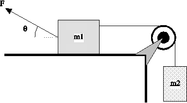

A 27.1 kg block (m1) is on a horizontal surface, connected to a 6.70 kg block (m2) by a massless string as shown in the figure below. The frictionless pulley has a radius R = 0.097 m and a moment of inertia I=0.070 kgm2. A force F = 213.7 N acts on m1 at an angle theta = 34.5°. There is no friction between m1 and the surface. What is the upward acceleration of m2?
Torque = F x R
Torque = I x alpha
a = R x alpha
I = 1/2 m x R^2
Block 1 : Fcos(theta) - T1 = m1a T1 = Fcos(theta) - m1a (opposite direction of accereration)
Block 2 : T2 - m2g = m2a T2 = m2a + m2g (in the direction of accleration)
Torque = (T2-T1)R = I x (a/R)
(m2a + m2g - Fcos(theta) + m1a)R = 1/2 m x R^2 x (a/R)
m2a + m2g - Fcos(theta) + m1a = (m x R^2 x a)/(2 x R^2) R^2 cancel out
m2a + m2g - Fcos(theta) + m1a = (m x a)/2
m2a + m1a - (m x a)/2 = Fcos(theta) - m2g
a (m2 + m1 - m/2) = Fcos(theta) - m2g
a = (Fcos(theta) - m2g)/(m2 + m1 - m/2) -----------------> A
a = (213.7cos(34.5) - 6.7*9.81)/ (6.7 + 27.1 - 17.88/2)
a = (110.39/26.36)
a= 4.187m/s^2
I know that the answer is 2.68m/s^2 and that the equation A should be
a = (Fcos(theta) - m2g)/(m2 + m1 + m/2)
But i don't know how to get that...

If m2 is supposed to accelerate upwards then m1 must be accelerating leftwards, right? That means the pulley should be accelerating counter clockwise. That would make T1 > T2 if you want to maintain the assumption of m2 accelerating upwards. So, rearrange your T1 and T2 in the above and redo from there.
Strange, that's not the value that I get. Let's see how you do and then we can compare notes :)
When I did
Torque = (T1-T2)R = I x (a/R)
It worked out perfectly :) thank you
