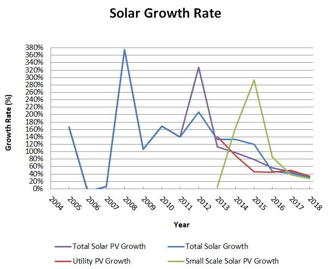

Yes, thanks for pointing to this. This is an issue I've been tracking and I have a spreadsheet and some analysis I'll share later.
We've previously discussed growth rates and scalability, and I have commented largely on two benchmarks:
1% (passed in 2016) was my threshold for considering solar power "relevant", meaning prior to that it was just too low to affect the grid or make realistic predictions about its growth. Opening one plant would skew a year's growth rate. We've passed that and growth rates have settled down.
10% is suspected to be the limit of practical exploitation based on Germany's model. We're about 5 years from that based on the current growth rate trend (about 40% now, and dropping pretty much every year).
Obviously the industry climate has a big impact on what happens next.
Likes Fisherman199
Solar utility scale generation
growth 2014 to 2015: 24893 / 17691 = 1.407, or ~41%
growth 2015 to 2016: 36054 / 24893 = 1.448, or ~45%
growth 2016 to 2017: 53286 / 36054 = 1.477, or ~48%

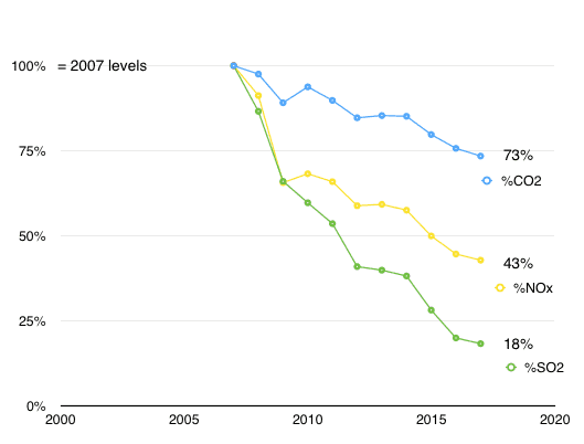

nikkkom said:
That sure is a fun page to ogle. I've created countless interesting graphs from it.
Quite the impressive reduction in SO2 over the last 10 years.
I'm guessing that's mostly because of a shift from coal to natural gas.
It will be interesting to see what it is in another 10 years, as solar increases.

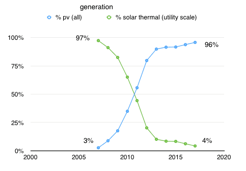

And imagine what the following graph would look like, if everyone followed the Drake Landing example:
Per wiki; "In the USA, HVAC systems account for nearly half of the energy used in residential buildings."
[edited for brevity]
As I've mentioned before, I will do what I can, when I can afford it*. Commercial and Industrial customers can figure it out for themselves.
* Coincidentally, on the day California senate bill 100 passed(Aug 28th), a rep from from my electric company showed up on my doorstep and talked me into signing up for 100% renewable energy. According to them, it will cost me an extra 5.5%. I still have no idea how they are going to provide me with 100% renewable energy, when such a thing doesn't exist, as far as I can tell, but, I did it anyways.
Also, by this day in 2021, I should be able to afford to both cut my neighbors trees down, and install a thermal sump.

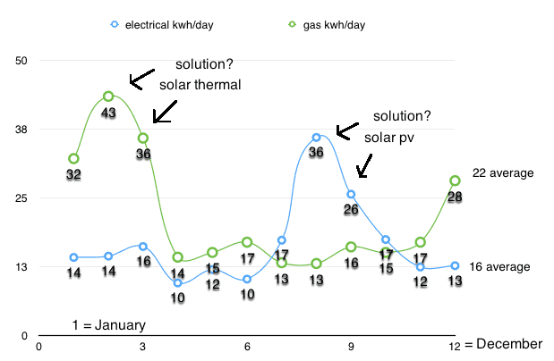

By "utility scale", I just mean enough energy storage to store several days of demand, if it is cloudy or raining, etc. I don't mean it has to be at the utility. It could be many Tesla Powerwalls or some other form of local storage distributed across millions of users. But if you look at the numbers, it is a daunting challenge. California uses about 800 GWh of electricity per day. If we want to store 2 days of this usage, we need 1600 GWh of storage. A Tesla Powerwall stores 14 kWh. So we would need 114 million of them. This is a tall order.
Huge numbers divided by lesser huge numbers = manageable numbers, IMHO.
Fortunately for me, I have a mole(my sister) who lives in a region(San Diego metro area) that recently(last year) provided me with her utility bill history.
Her average "electrical" consumption (16 kwh/day) is quite close to your 19 kwh/day, so I'm going to call her a good source of empirical data.
And as far as I can tell, more than half (22,000,000) of Californians live the the Los Angeles and San Diego statistical areas.
Now, I may not be a genius, but if it's hot enough that you have run your a/c, then the sun is probably shining. Hence, no need for "electrical" storage. And given that "solar thermal" is 10 times as efficient as "solar pv", I'm going to guess that heating is 10 times less a problem, area and cost wise.
mfb said:
At $80,000 per piece that would cost $600B, or $15,000 per capita
This kind of brings my sister's next door neighbor into the equation.
He paid umpteen thousands[aka bazilions!] of dollars to install a 5 kw solar pv array, 20 years ago. Why should he have to subsidize those who couldn't afford it?
ps. My sister installed insulation in her attic this year. I'll ask her next year, in March, what happened to her utility bills.
Yay science!
What does "10 times as efficient" mean? The sunlight->useful energy conversion can't be 10 times better, solar PV has more than 10%.
I rounded.

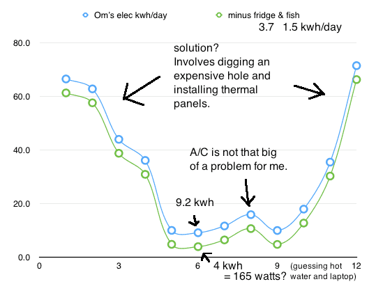

phyzguy said:
I have solar panels on my house also. Averaged over the year, I generate more electrical energy than I use. But I don't have any energy storage, so I get power from the utility at night and in the winter. How do you deal with this?
As I alluded to above, I don't. My panels are just a hobby.
Do you have energy storage in your home, and if so, what kind?
If I did have access to southern California levels of sunshine, I'm sure I'd figure it out. But since I don't, I haven't.
We have stretches of MONTHS without sunshine.
Hence, why that solar thermal installation in Canada, so intrigues me.
My "off base" requirements mostly involve the "heating" portion problem of "HVAC".
Refrigeration will require a new refrigerator. Mine is actually quite old, and the nameplate data on new ones indicates and I could cut my base load down to 2 kwh/day with a very small investment.
ps. Got rid of my "tropical" fish.
pps. Hey! That reminds me. I never solved how much energy my back porch light was costing me:
3958 hours ≈ 165 days
5.62 kwh
yields 0.034 kwh/day. (2.8 watts continuous)​
Quite a bit higher than my estimated 0.0083 kwh/day. (0.7 watts continuous)
But still, quite reasonable.
I love my Kill-A-Watt [hour] meter.
