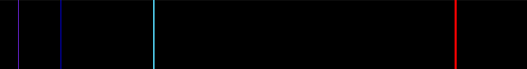

Oh that's what you meant. Once you calculate the difference in shifted spectral lines, you can figure out the speed at which the galaxy is either moving towards you, or moving away from you. I don't know the technical details or math involved in the actual calculations, but it's similar to red shifting and blue shifting. Spectral lines will shift towards the red when the galaxy is receding, and blue when it's approaching us.
How wud we know which spectral line has shifted how much, if there are lines presnt all over...
Spectral Lines are optical signatures of certain elements. They appear at the exact same wavelength all the time. If we measure the spectral lines of a single element, we know which lines correspond to that particular element. Once we have a bunch of spectral lines from multiple elements in one spectrograph image, we can then see what spectral line corresponds to what element.
Once we know what elements are being displayed, we can then figure out how much they have shifted from their base positions.

The emission or absorption lines of an element are like fingerprints. The following image is of the emission lines of hydrogen that fall within the visible range. Redshift and blueshift results in a shift of all four lines in the same ratio. For example, let's say a source of hydrogen is moving towards us fast enough so that the wavelengths of the emission lines will be half what they normally are. The red emission line at 656.2 nm would be blueshifted to 328.1 nm, while the blue-green line at 486.1 nm would be shifted to 243.05 nm. Make sense?
