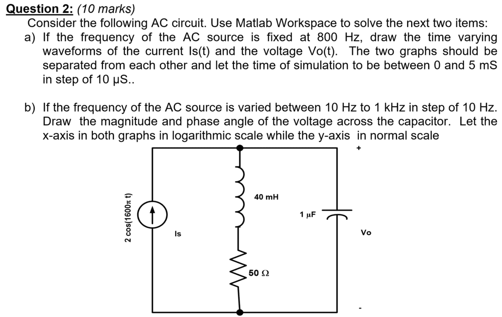

The question is attached below.
The plot of part b is attached below.
I got a warning on part a , I don't know where is my mistake .
Please check my work .

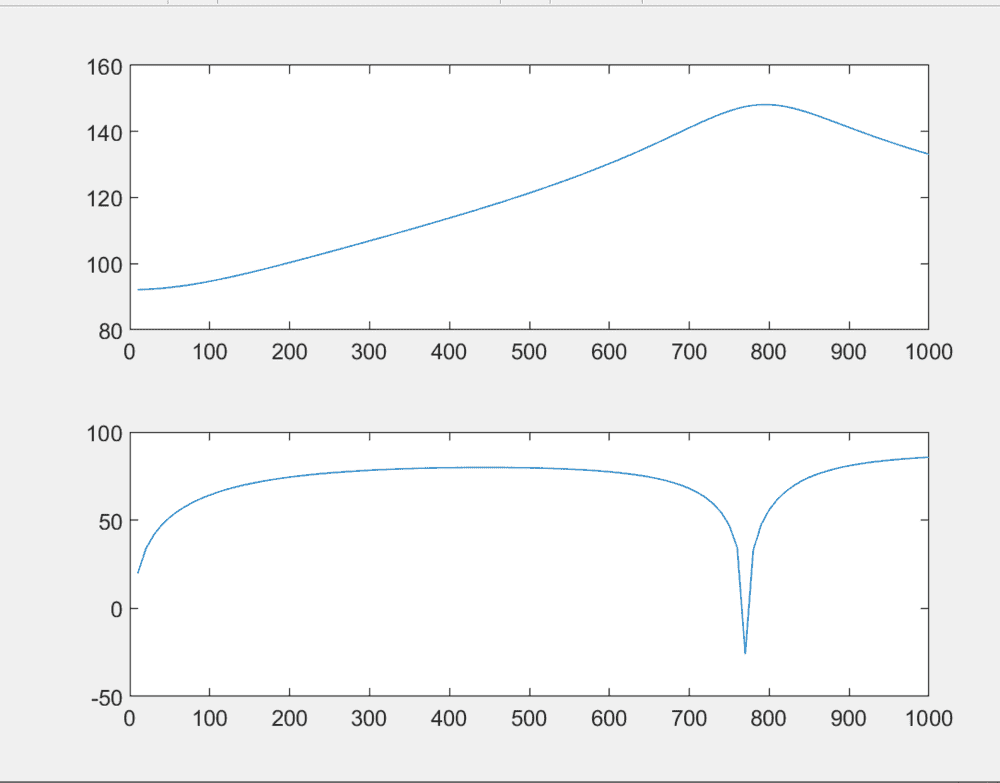

logscale1=20*log(abs(vo));
logscale2=20*(log(rad2deg(angle(vo))));
subplot(2,1,1) , plot(f,logscale1)
subplot(2,1,2) , plot(f,logscale2)

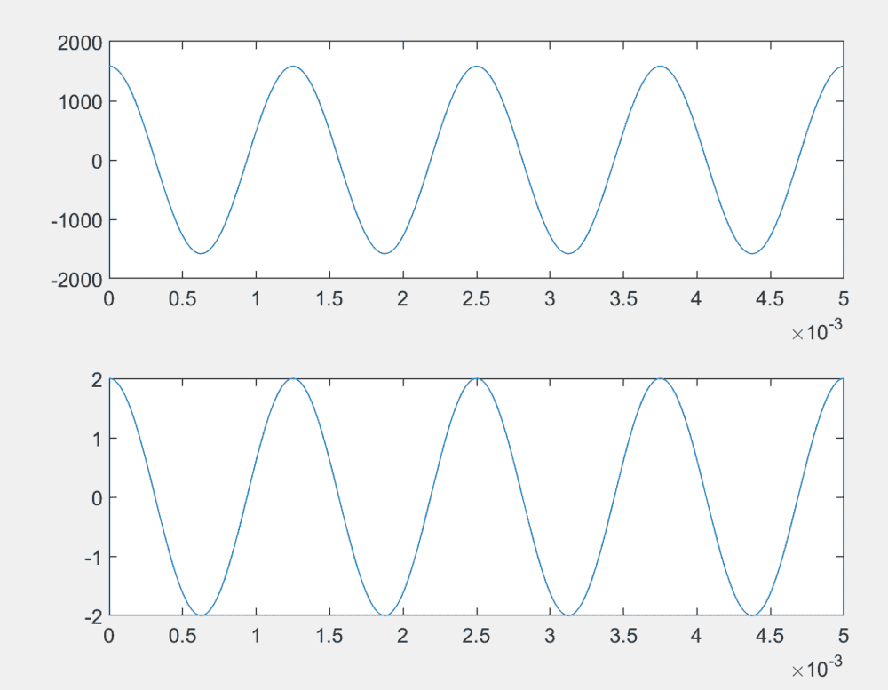

I resolve it again .
Plots are attached below.
Matlab:
clc;
clear all;
%parta
f=800;
xl=40e-3;
xc=1e-6;
r=50;
t=0:1e-6:5e-3
is=2*cos(1600*pi*t);
w=2*pi*f;
l=xl*j*w;
c=1/(xc*j*w);
z=l+r;
zeq=(z*c)/(c+z);
vo=is*zeq;  %v=total current*total Z
figure (1)
subplot(2,1,1) , plot (t,vo)
subplot(2,1,2) , plot (t,is)

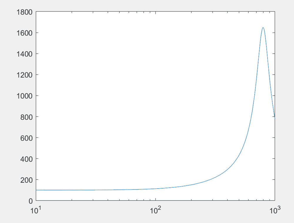

f=10:10:1000;
xl=40e-3;
xc=1e-6;
r=50;
for i=1:100 %(1000-10)/10+1=100
    w=2*pi*f(i);
    c=1/(xc*j*w);
    l=xl*w*j;
    z=l+r;
    zeq=(z*c)/(z+c);
    is=2*(cosd(0)+sind(0)*j); %convert to rectangular form
    vo(i)=is*zeq;
    vom(i)=abs(vo(i));
    voa=rad2deg(angle(vo(i)));
end

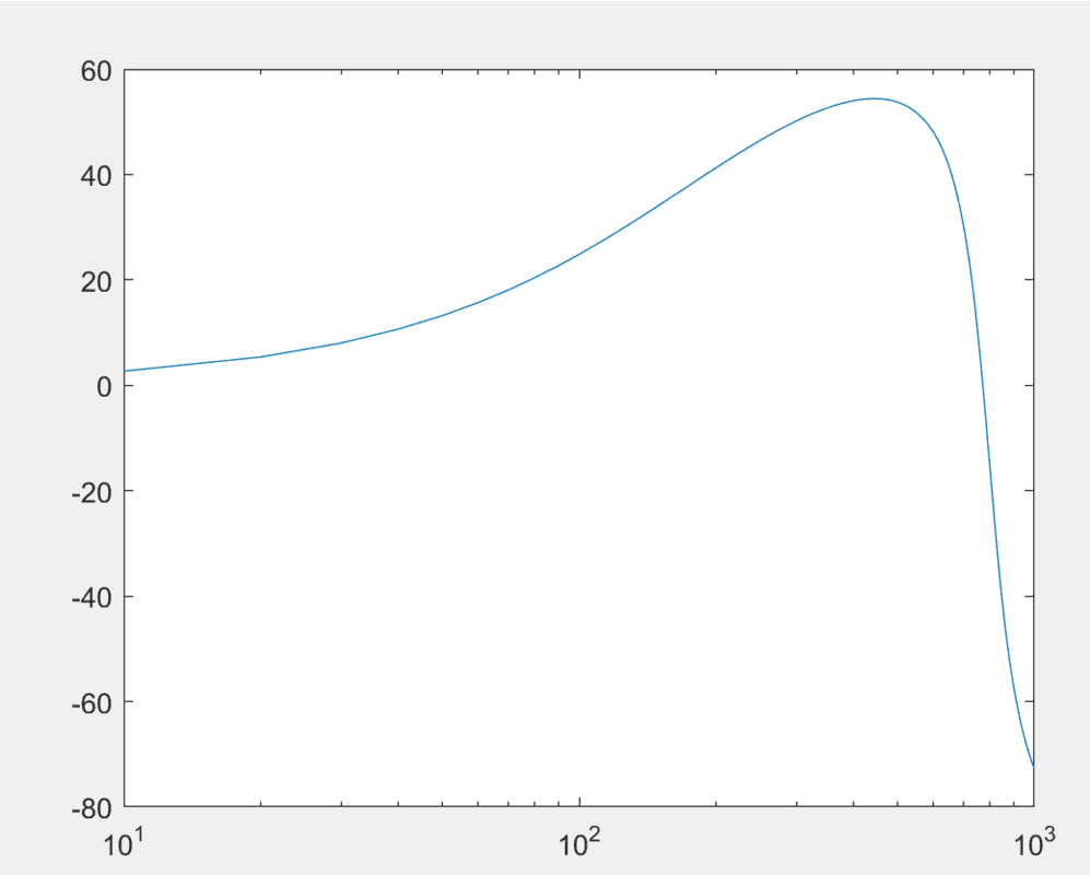

figure (2)
    semilogx(f,vom)
figure (3)
    semilogx(f,voa)
I missed (i) , it should be voa(i)=rad2deg(angle(vo(i)));
