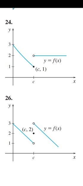

For questions 24 and 26, Use the graph to investigate limit of f(x) as x→c. If the limit does not exist, explain why.
Question 24
For (a), the limit is 1.
For (b), the limit is cannot be determined due to the hole at (c, 2).
For (c), LHL does not = RHL.
I conclude the limit does not exist.
You say?
Question 26
For (a), the limit is 2.
For (b), the limit cannot be determined due to the hole at (c, 3).
You say?

Ques. 24
No, this is incorrect. The presence or absence of a hole doesn't affect the limit.
As x approaches c from the right, what are the function values doing?
This is the correct conclusion, but you've based it on faulty reasoning.
Ques. 26
No to both. As x approaches c from the left, what value are the function values approaching? The fact that the point (c, 2) is on the graph has nothing to do with what the limit might be.
As x approaches c from the right, what are the function values doing, again ignoring the point at (c, 2)?
Correct conclusion but based on faulty reasoning.

Let me reply to yours one at a time from top to bottom.
1. As x tends to c from the right, f(x) goes to a height of 2.
2. Let me try 26 again.
As x tends to c from the left, f(x) goes to a height of 1.
As x tends to c from the right, f(x) goes to a height of 3.
Since the LHL does = THE RHL, the limit for f(x) does not exist.
You now say?
They're all fine now.
