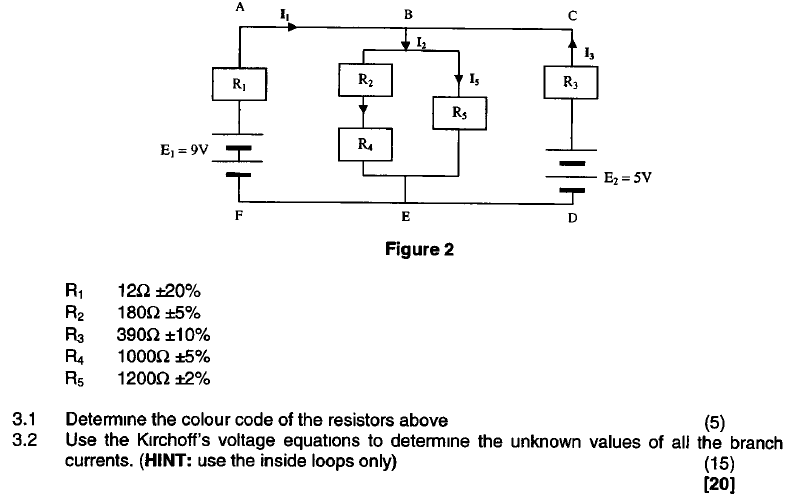

Use KVL to determine values of branch currents
In summary: Fortunately, you've already calculated those. You should be able to take it from there.I1=I2+I3=0.015+0.013=0.028AWhich is the same as the answer in my study guide. So I5 is not needed to be calculated?In summary, the conversation discusses solving a circuit problem using Kirchhoff's Voltage Law (KVL). The first attempt at a solution is incorrect as the voltage across a 12 ohm resistor is assumed to be 9 volts, which is not the case. The correct approach involves assigning currents to all branches and using KVL to solve for the unknown
DevonZA
181
KVL: At any instant in a closed loop the algebraic sum of the e.m.f's acting round the loop is equal to the algebraic sum of the p.d's round the loop.
3.1

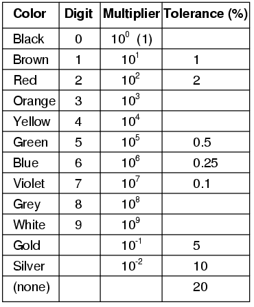

R1 = BROWN, RED, BLACK, NONE
R2 = BROWN, GREY, BROWN, SILVER
R3 = ORANGE, WHITE, BROWN, GOLD
R4 = BROWN, BLACK, RED, SILVER
R5 = BROWN. RED, RED, RED
3.2
I want to add R2 and R4 because they are in series. 180ohms + 1000ohms = 1180ohms
The R2+R4 are in parallel with R5. (1/1180+1/1200)^-1=594.96ohms
Using KVL:
V=IR
9=I1x12
I1=9/12=0.75A
I2=9/594.96=0.015A
I3=5/390=0.013A
Okay so I'm pretty sure this is not correct but the middle area with R2, R4 and R5 is really confusing me.
Why is there I5 when we already have current I2?
Also I assume I4 is the little arrow indicated above R4 but by that reasoning then there should be a current above R2 as well?
Please help me understand this.

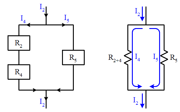

Once you have I2 you can isolate the R2-R4-R5 subcircuit and determine the currents in its two paths. There are a few choices of method to do so including using the current division rule or the common potential difference that is across the two.

One branch has a total of 1180 Ω, the other 1200 Ω. The current division rule uses the total resistances in its equation.
Note that you should use parentheses to make the order of operations unambiguous:
I5 = (1180/(1180 + 1200) )xI2
I assume you are happy with the way I calculated I4? Or at least where I think I4 is
Nope. You've not applied current division correctly for the two paths that I2 splits into.
Edit: Here's a diagram that portrays the situation with its equivalent simplified form on the right:
Likes cnh1995

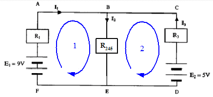

Let's step back and take a fresh run at the problem. I think you're relying on equations that haven't been vetted.
Taking the version of the circuit (from post #4) where the central resistors have been reduced to a single value (594.958 Ω):
Write the two KVL loop equations and the KCL equation for the junction at point B. You can write them symbolically for now; forget plugging in numbers for now.
Your patience is appreciated.
Loop 1 analyzing in a clockwise direction:
emf's = +9V
voltdrops = +I1R1+I2R245

Not so good for loop 2. Note the directions that I2 and I3 are defined to flow through the resistors. You are KVL-walking against those flows as you go around the loop clockwise. So rather than encountering potential drops, you're passing through potential rises there.
Rewrite the equation for loop two taking this into account, and then write the KCL equation for junction B.
Edit: Hold on, I just realized that I made an error in assessing your work! :nb) :blushing:
I wrote the equations summing rises rather than drops and failed to "translate" the signs properly to compare with yours.
Your two equations are both fine. Can you write the KCL equation to give you the required third equation?
Analyzing clockwise:
We are traveling through R245 against the current I2 which according to my study guide means that we get -I2R245
We are traveling through R3 against the current I3 which according to my study guide means that we get -I3R3
I'm sorry I really don't understand, I am not trying to be funny.
At Junction B according to KCL: I1-I2+I3=0 or I3=I2-I1

9=I1R1+I2R245
9=I1(12)+I2(594.96) ...1
-5=-I2R245-I3R3
-5=-I2(594.96)-I3(390) but I3=I2-I1
-5=-I2(594.96)-(390)(I2-I1)
-5=+I1(390)-I2(984.96) ...2
9=I1(12)+I2(594.96) x 32.5
= 292.5=I1(390)+I2(19336.2)
-5=+I1(390)-I2(984.96) -
= 297.5=I2(20231.16)
I2=0.015A
Sub into 1:
9=I1(12)+(0.015)(594.96)
I1(12)=0.0756
I1=0.0063A
I3=I2-I1
I3=0.015-0.0063
I3=0.0087A

Once you've squared away accurate values for I1 and I3, and using your new improved accuracy I2, tackle the current division in the central network:
gneill said:
Yup. Make a habit of not rounding anything (except for presentation) until the very end.
Will do, thanks again for your help.
Now to find I4 and I5 :
Is this correct
= 0.0074A
I4=R5/R2+R4 +R5 x I2
=(1200)/(1180+1200) x 0.015
= 0.0076A

I4=((R5)/(R2+R4))xI2
= (1200/1180)x0.015
= 0.01525A
I5=((R2+R4)/(R5)xI2
= (1180/1200)x0.015
= 0.01475A
Okay I need to sleep, will check back in the morning.
Thanks again gneill really appreciate your time and effort in assisting me.
DevonZA said:
Sorry gneill I am asking silly questions.
I missed your point about using current division, apologies it is getting late here.
No, it's a valid approach to first find the potential across the middle subcircuit and then find the currents through its parallel branches using Ohm's law. In fact I'd recommend doing so for a check on the current division results.
To find the potential difference across the middle subcircuit, that is the potential between points B and E, do a KVL walk from E to B either through the E1 path or the E2 path. You know the currents I1 and I3 so you can apply Ohm's law to find the drops across resistors R1 or R3. Beware of actual current directions.
A note on current division:
When you have two parallel paths with resistances ##R_a## and ##R_b## and an entering current ##I##, the individual path currents are given by ##I## multiplied by resistance of the "other" path divided by the sum of the two path resistances. So for example:
##I_a = I \frac{R_b}{R_a + R_b}##
You should prove this property to your satisfaction so that it becomes second nature to apply it, and so you can quickly re-derive it should you forget :smile:
