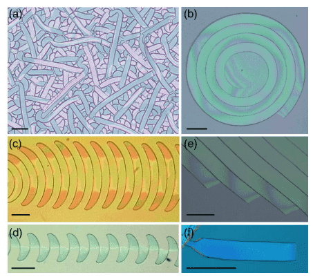

So I am constructing an analogy between the self replicating fracturing effect on thin films and the path of a charged particle. (Qualitatively, several cracks have similar shapes to charged particle motion) I won't go into the details of the fracture mechanics, so I will only use E+M nomenclature.

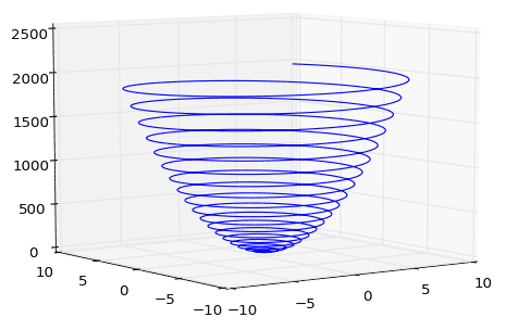

My problem: Start with a parameterized path function, s, of a charged particle from which the velocity and acceleration functions can be easily derived. (a and R are constants)
$$\vec{s} = ( tcos(at) , tsin(at),(x^{2} + y^{2}) R )$$

Thanks, do you have any insight for the 3D example? Can it be done using the same algorithm you proposed for 2D? I am working in 3D because the delamination of the thin film cracks creates an upwards peeling effect along with the planar propagation of the crack.
So, the example I used for the path function was the Archimedian spiral (b), but it actually has a parabaloid shape. When I started this work, I was thinking in 2D, but the delamination peeling is actually really integral to these cracks. (The peeling is seen via the color warping between crack lines)

A paraboloid shape simplifies things, because that means the force in the z-axis is a constant. Since ##z = Rt^{2}##, you know that ##a_{z} = 2R## and thus ##F_{z} = 2mR##. A constant ##F_{z}## requires that ##B_{x} = B_{y} = 0## and ##F_{z} = qE_{z}##, or else the z-component of acceleration would depend on velocity in the plane. ##\nabla \cdot \vec{B} = 0## implies that ##B_{z}## is constant. That makes the problem effectively 2D, and maybe the algorithm I suggested can solve it.

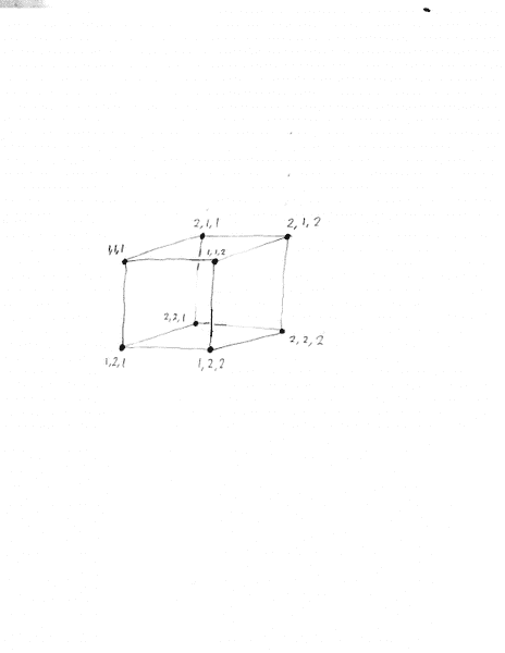

Consider a 2 by 2 by 2 cubic grid of points, where each point is given by three indices as shown in the attached image (sorry for the low quality!). You have 6 unknowns per point and 8 points, so 48 unknowns total.
First, we have to formulate the field equations over the discrete mesh. In general, if we use (i,j,k) to denote the indices of the points, then ##\nabla \times \vec{E}=0## turns into three finite-difference equations (using forward differences only):
##\frac{E_{z}(i,j+1,k) - E_{z}(i,j,k)}{\Delta y} - \frac{E_{y}(i,j,k+1)-E_{y}(i,j,k)}{\Delta z} = 0##
##\frac{E_{x}(i,j,k+1) - E_{x}(i,j,k)}{\Delta z} - \frac{E_{z}(i+1,j,k)-E_{z}(i,j,k)}{\Delta x} = 0##
##\frac{E_{y}(i+1,j,k) - E_{y}(i,j,k)}{\Delta x} - \frac{E_{x}(i,j+1,k)-E_{x}(i,j,k)}{\Delta y} = 0##
(It might work out better if you use the average of forward and backward differences for the discrete derivative, but those are practical details you'll only know once you implement. See https://en.wikipedia.org/wiki/Finite_difference for explanation of forward and backward differences.)
And the remaining field equation ##\nabla \cdot \vec{B} = 0## becomes
##\frac{B_{x}(i+1,j,k) - B_{x}(i,j,k)}{\Delta x} + \frac{B_{y}(i,j+1,k)-B_{y}(i,j,k)}{\Delta y} + \frac{B_{z}(i,j,k+1) - B_{z}(i,j,k)}{\Delta z} = 0 ##
This gives 4 field equations per point and 8 points, so 32 equations in 48 unknowns.
Then apply the equations of motion at each point, ##\vec{a}(i,j,k) = \vec{E}(i,j,k) + \vec{v}(i,j,k) \times \vec{B}(i,j,k)## where ##\vec{a}## and ##\vec{v}## are known for all (i,j,k). That gives 3 equations per points and 8 points, so 24 equations in 48 unknowns.
Taking the field equations and equations of motion together, you have 56 equations in 48 unknowns. My interpretation of this is that not every velocity/acceleration pattern is compatible with a static electromagnetic field. There is a catch though, because if you do this numerically the odds of getting a perfectly solvable system are slim, because all it takes is one slight deviation in the last decimal place of a floating point number to make the system unsolvable. With that in mind, you may need to resort to a least-squares solution if the direct approach fails.
Let me know if anything wasn't clear.
P.S.: As you can see, the linear systems get very large very fast (in this case, 56 equations in 48 variables for an 8 point grid). You will need to use sparse matrix encoding (supported in MATLAB, BLAS, Lapack, and Armadillo, that I know of, plus probably a lot of others I don't know of) to reduce the memory load.
