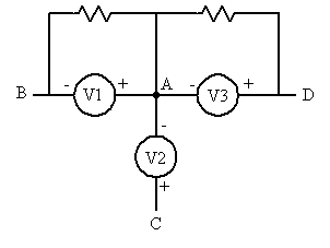

Supernodes contain nodes which are connected to each other by voltage sources. These voltage sources define the potential differences of the nodes, so just do a KVL "walk" from one to another and note the potential change due to the voltage sources.
Consider the following circuit fragment which might be considered as a supernode in some larger circuit.
Nodes A, B, C, D are all separated by voltage sources. That is, you can "walk" a path between any of these nodes passing only through voltage sources; going from B to D would pass through V1 and V3, for example.
Suppose you choose Node C as the reference point for this supernode. Then "walking the path" from C to B yields Vb = Vc - V2 - V1, and that's the expression you'd use in place of Vb when writing your circuit equations.
Thanks, I think that has made it clear for me, hopefully. lol.
