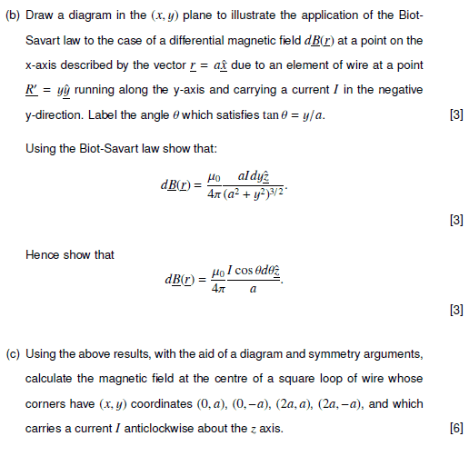

My question concerns the integration of the biot savart law of a differential magnetic field element to find the magnetic field at the center of a square loop. The question is part (c) (using info from (b)) of the image below:
I want to check if what I did was right, but what I did was to integrate the differential magnetic field element separately for each of the 4 sides, using the fact the angle varies between 45 and -45 degrees for each side. So basically I multiplied the integral of the differential magnetic field by 4 and integrated across the limits of 45 degrees and -45 degrees to attain:
[tex]B=\frac{\sqrt{2}\mu _{0}I}{\pi a}[/tex]
Is this right?
Many thanks for any help/comments!
SK
Hey Sekonda! :wink:
Yup, looks ok. :smile:
(btw, [3] is the differential form of the usual (µo/4πa)(sinθ1 - sinθ2), = µo/2πa for an infinite straight wire :wink:)
