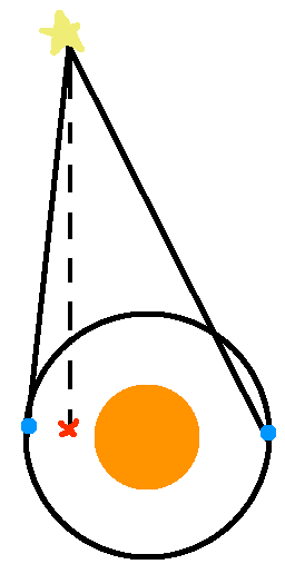

This isn't a very technical series of questions, just some passing thoughts I had whilst looking over some notes I had on stellar parallax distancing.
Stellar parallax is always described as a means of "measuring the distance to stars." But from where?
What I mean is, the distance, or the side of the right-angled triangle that's calculated is not a line joining the Earth and said star. It goes down from the star to some arbitrary point between the two positions of the Earth seen over a 6-month interval. If that wasn't clear I've made a drawing and stuck it in the spoiler below (see red 'x'):
Is this distance value typically adjusted later on in any way to make it more meaningful? If it is, what becomes the new reference point, since the Earth is constantly in motion? Is it the Sun?
Thanks

The stars are so far away that it really doesn't make much difference whether you are talking about the distance from the Earth at one side of the orbit, the distance from the Earth at the other side of the orbit, or the distance from the Sun. It's like asking whether the distance from where you are to Moscow is the distance from your left eye or your right eye. But, to answer your question, I think astronomers generally use the distance to the sun as the reference point.

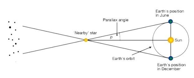

Your picture should look like this: The Sun, Earth and star make a 90 degree triangle

Yeah that's what I was thinking, the difference is probably tiny (relatively) Thanks
JCMacaw said:
Your picture should look like this: The Sun, Earth and star make a 90 degree triangle View attachment 98337
Yeah that was actually my next question, does it matter? I was wondering if it would be right to say that if the two angles from the star were added up and divided by 2 that would be equivalent to if the star were equidistant from both positions of Earth. So that's not the case, can I know why my assumption was wrong? Cheers
What's wrong with your drawing is that we choose the times during the year that maximize the parallax, which is when the line between the two Earths is perpendicular to the line from the sun to the star. So the point halfway between the two Earths is at the position of the sun.
It's not very useful, it's useful for only a handful of the nearest stars. It may not be useful because it doesn't work at great distances, but works very accurately for close stars, and considering we have no other way to determine distances accurately except for extreme distances like to cephiad variables and type iib supernovas, I'd say it's usefulness is pretty high.
Pardon my asking but I have a few more questions
If we choose specific times of the year to maximise parallax, how is that done if we don't know how far away the star is?
Also if that's the case then the two angles measured at the opposite ends of Earth's orbit are going to be the same. Why measure both angles when you could just measure one, if you know that the angle is going to be the same on the other end? Is it to average them and reduce error?

For that, we don't need to know how far away the star is, do we? Only its direction.

You need the maximum separation between your observation points. Its like having a wider distance between your eyes(our eyes have evolved for an optimum distance for our environment.) Then you can use the "skinny triangle" approximation for most cases. Wikipedia has an article on skinny triangles. ALL observations of stars involve skinny triangles. I know, I know, for optimum results don't approximate. The you might get the distance as 10.01 pc as opposed to 10 pc.
