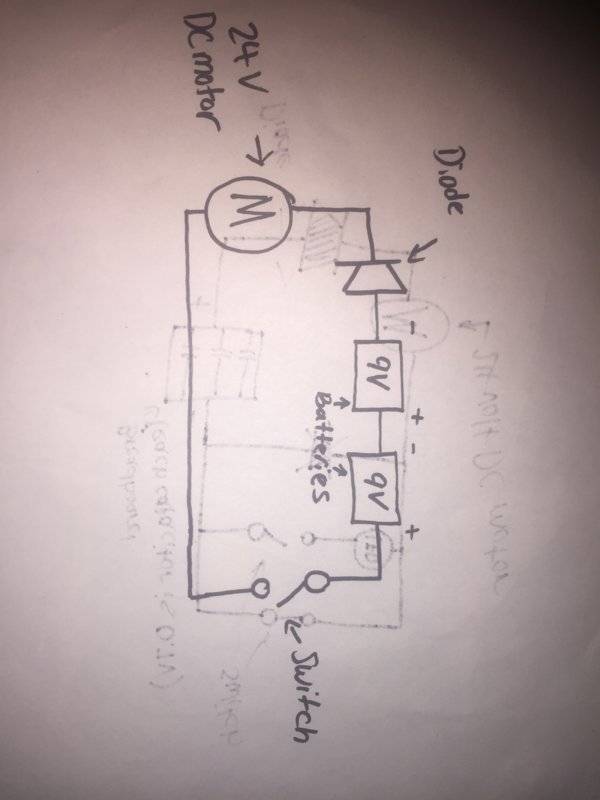

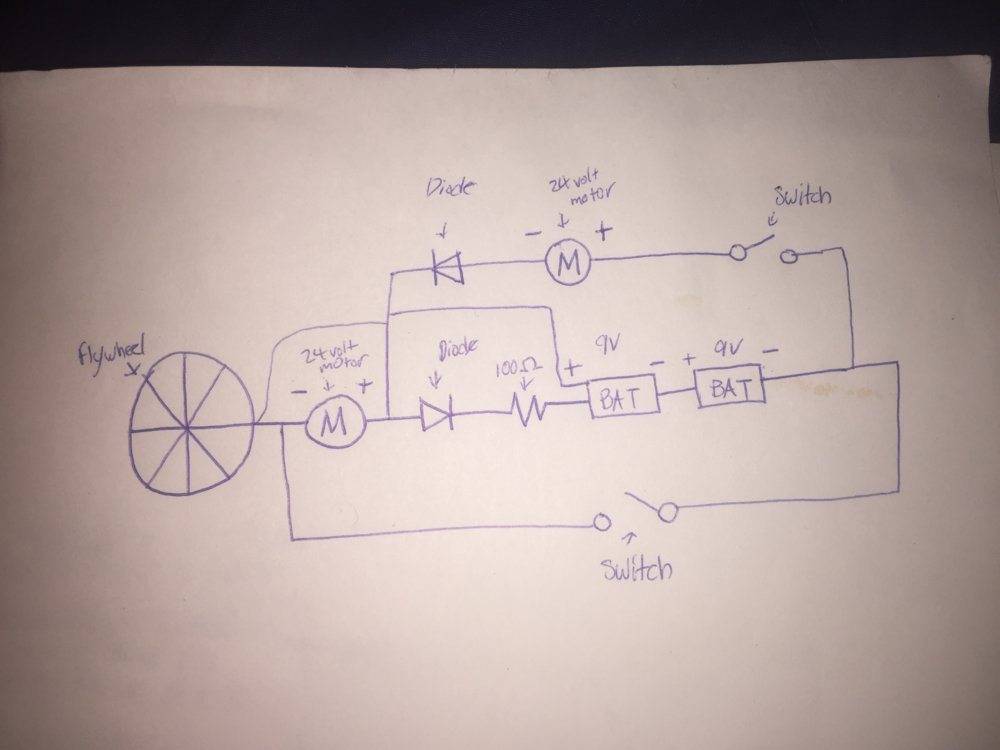

Hello,
I have a 24 volt motor connected to two 9V rechargeable batteries in series and a battery connected to a switch then back to the motor. I want to be able to charge the batteries directly from the motor when the switch is off & have the battery power the motor when the switch is on. Motor/generator. When the switch is on the motor runs, when the switch is off the rechargeable batteries don’t charge, any idea to get them to charge?
My project is to create a circuit for a stroller that can store the mechanical work into electrical while moving around and with the push of a switch, use the electrically stored energy to assist the movement of the stroller. I’ve tried capacitors but it ended up not being enough voltage and I didn’t want to deal with the danger, so I’ve been using two 9V/175mAh batteries, however when I set up the circuit and add a switch in the closed position, even though, the connection is closed the batteries can’t be charged while the switch is off and when the switch is on the batteries power the motor, any ideas to solve this issue? Thank you!
Welcome to the PF. :smile:
The overall goal of the project seems good, but there are so many things wrong with your initial thinking, it's hard to sort them all out.
  • You want to drive a 24V motor with 9+9=18V worth of batteries?
  • What current does the motor draw when driven with its rated DC voltage?
  • You need some conversion circuit between the motor (when it's a generator) and the batteries to act as a charging circuit -- what is your experience designing battery chargers and DC-DC converters?
  • Standard 175mAhr 9V batteries are not a good match for driving an electric stroller (but I'm not confident in recommending an appropriately sized battery for this project, because so far you don't seem to have the background to work with that kind of energy safely)...

1) yes
2) 0.5 Amps
3) Nothing, this is a senior project for my mechanical engineering field so as for building extensive circuits I’m basically a novice
4) And yes your not wrong, I can't use a 12 volt battery or anything like that anyway, since I have to worry about the weight of the system. I know the capacity is low but I really more worried about the configuration necessary to charge the batteries when the switch is off, I connected 1.2 batteries in series and spun the motor by hand to recharge the batteries directly so I know it’s capable but for that to be accomplished the batteries would have to have a connection to the power and the ground so batteries will be powering the motor as long as the batteries have a connection to ground. So you’ll definitely know more than me concerning all of this, any ideas come to mind?

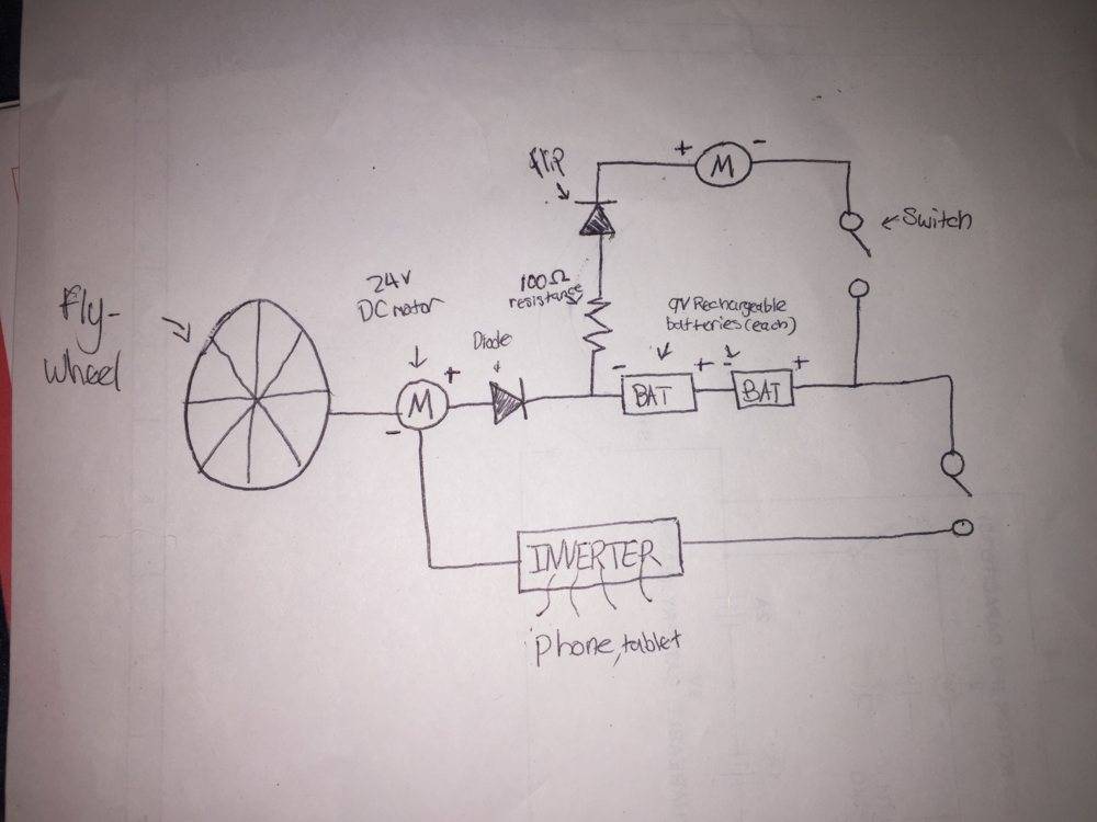

Oh right, because V=IR is so simple yet I never use it when I actually need it haha, thank you for that diode tip @Tom.G it really helped a lot. Thank you as well @russ_watters that's very helpful for the next stage of the project. Thank you ! I ended up getting it to work, I’ll end up using a motor on both the wheels, so one motor will be used to charge the batteries when the bottom switch is off and the top switch is on & then the system will be powered by the batteries when the bottom switch is on and the top switch is off; circuit down below. I’m waiting for my partner to 3D print some pieces so that we can have it fit on the wheel comfortably; so I’ll announce if it succeeds but I tested the “charging only” part of the prototype circuit I have with two D rechargeable batteries and it performed perfectly so I’m hopeful
I drew the one of the diodes the wrong way on the wrong way but you get what I mean haha
A few questions.
  • Could you mark the battery polarity? That will help us sort out what the design assumptions are.
  • The "Inverter" is shown in series with the drive motor. That is not likely to work well. Did you want it across the batteries?
  • Which Diode has the wrong polarity? Actually, I think there is an extra one!
Cheers,
Tom
Tom.G said:
A few questions.
Cheers,
Tom

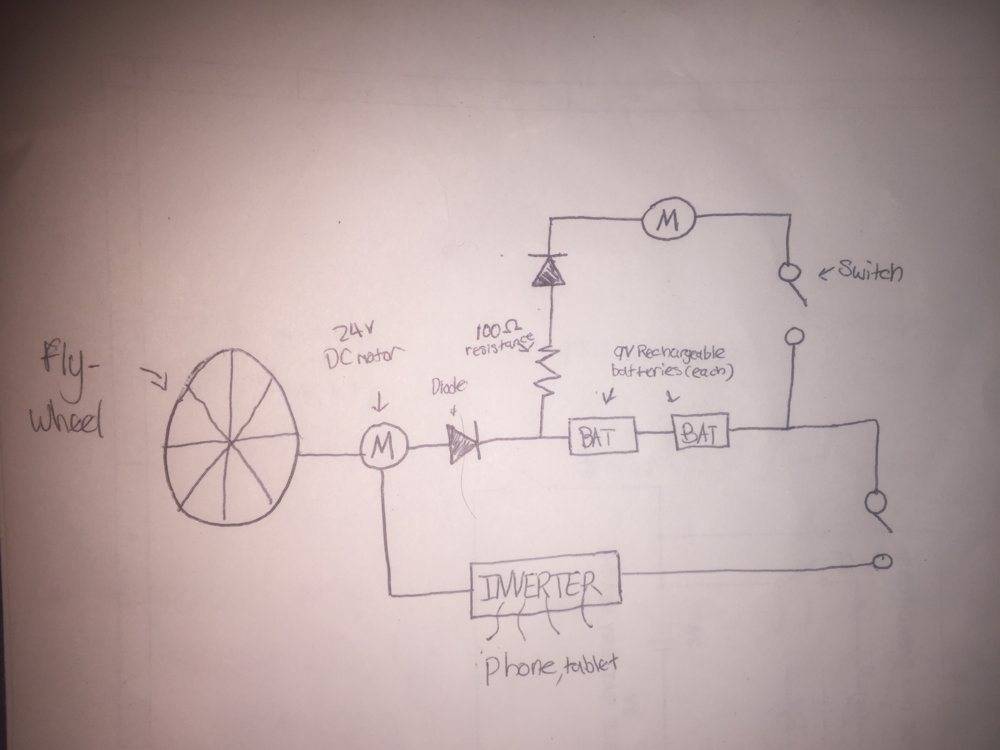

Hello, @Tom.G
I added some labels
And the inverter won’t work there? So should the inverter be in parallel with the batteries, like this?
if that’s the case, I would probably need to add another switch at the inverter so it doesn’t take away from the battery charging process
And yeah the diode labeled flip can actually be taken out entirely, since it won’t change anything
Yes.
Maybe. From a total energy usage standpoint during charging it is better to use the energy directly rather than storing it in a battery. This is because there are losses in both charging and discharging the batteries. So putting the energy in the batteries just to use it later for something (charging a phone) that can be done at any time wastes a little bit of energy.
However a switch for the inverter is a good idea because it won't be needed all the time... and you don't want to drain the batteries if no one is charging their phone!
Toeman123 said:
And yeah the diode labeled flip can actually be taken out entirely, since it won’t change anything.
It is actually the other diode I'm thinking is not needed. The diode labelled "flip" may or may not need to be flipped! That depends on whether both motors are mounted on the the same side of the vehicle or opposite sides. Can you see why flipping depends on where the motors are mounted? Or maybe I'm missing something. Can you explain the need for that lower diode?

@Toeman123: I don't think an inverter does what you expect it to do.
In your circuit nothing can charge the batteries.
The motors will be on opposite sides of one another on the stroller

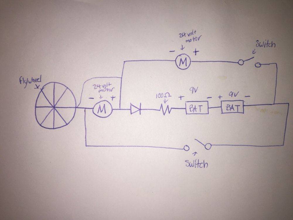

And relooking at the circuit, to be honest the diodes won’t be necessary, since the switch’s cut off power already, making the issue of the batteries powering the motors involuntarily while charging irrelevant; I believe I only added them when I was trying to determine a circuit with only one motor, that could perform the charging system and also be powered by the batteries
And hmm in this case wouldn’t the first motor (next to the flywheel) not add to anything since the switch will be off when the charging operation is happening, but the diode on the charging section, if flipped can only allow the motor to provide electrical energy to the battery and not vice versa so I understand what you mean there, however I am confused on the side that the motors are placed on can change what the diodes position is, my assumption is that when the motor is charging the batteries, the motor next to the fly wheel is not providing any assistance since the second switch is off, so I would think the side wouldn’t matter since they are performing separate operations right?
What do you mean? The batteries charge when the top switch is closed/ bottom switch is open and then the battery powers the system when the switch on the bottom is closed and the top switch is open.
And I only need the inverter to show my professor that the energy stored can be used to power a phone charger and something around that
The diodes prevent any charging current. In both parts you can only discharge the batteries and drive the motors.
Edit: And it looks like the motors would prefer the opposite polarity.
Starting from behind the stroller, move to the right side of it. If the stroller were to move forward the wheels would turn clockwise.
Now move to the left side of the stroller. Which direction do the wheels turn if the stroller moves forward?
The rotation direction a DC motor depends on the polarity of the applied voltage... and the polarity of a DC generator changes depending on the direction of rotation.
As for the upper diode being useful, yes it will work without it. However the usability of the stroller will be enhanced with it. I highly recommend that you have a diode on hand to try in the circuit to see any effects for yourself.

Oh wow yes you’re right the polarity, so one will be going CW and the other CCW but that can be handled by flipping the red and black wires I believe, so that when i move forward, the motor is also generating electricity on both sides
And yeah mostly getting rid of the diode would create more issues, since the battery would just power the motor meant to be charging until I turned the switch off, there’s be no reason to get rid of it since it makes the circuit more manageable
Likes Tom.G
Toeman123 said:
Oh yeah I put flip on the diode for the top diode, because I put it in the wrong direction
I took that into account.
In your circuit, with the diode flipped, current can only go from the positive battery terminals to the negative terminals: The batteries can only discharge but never charge.
Toeman123 said:
what do you mean by that last part sorry?
You connected the positive terminal of the motor to the negative terminal of the battery. Sure, you can also change the way you connect it to the stroller, but the assignment of these terminals in the circuit diagram is a bit odd.
In your circuit, with the diode flipped, current can only go from the positive battery terminals to the negative terminals: The batteries can only discharge but never charge.You connected the positive terminal of the motor to the negative terminal of the battery. Sure, you can also change the way you connect it to the stroller, but the assignment of these terminals in the circuit diagram is a bit odd.
Ohh thank you I understand what you mean, unless it’s positive to positive and negative to negative, the only scenario that will occur is a loss of energy. I made the circuit resembling a more accurate depiction. Let me know what you or anyone else thinks. Thank you all for the help!
Now you can only charge it but don't discharge it.
You need a diode in one direction for charging and in the other for discharging.

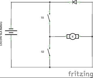

  • #31

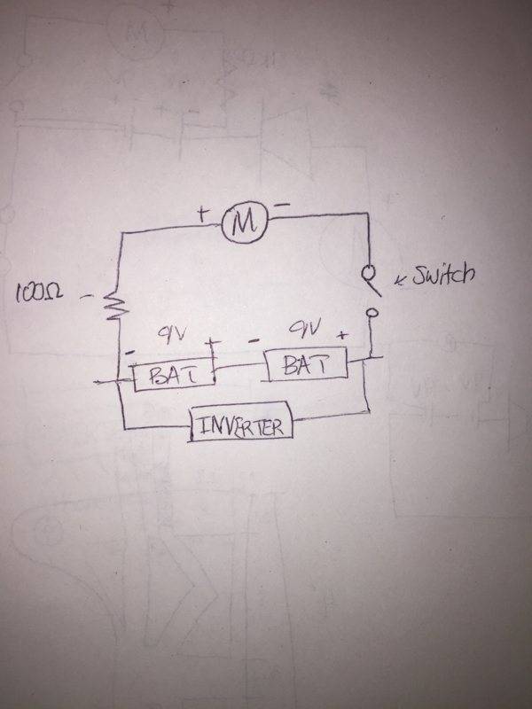

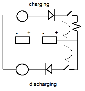

Hmm are you saying something like this would need to happen so the battery can give electrical energy to the motor?
Thank you for your help!
  • #32
Now the diode and the resistor just do nothing because there is a cable.
Here is a simple circuit. The thin arrows indicate the direction of current flow in the two modes. You can replace the two switches by a single three-way switch if you always want to be in charging or discharging mode.
  • #33
Yeah wow, sorry, I was so focused on that, I didn’t even realize the whole circuit would be useless, would the polarity on the motors would be the same or opposite in the picture? To perform the operation?
