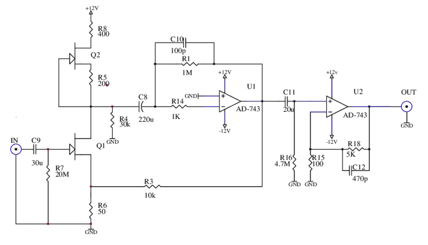

An input stage with a large dynamic range can be very complex, as shown in this figure.
Likes brainbaby

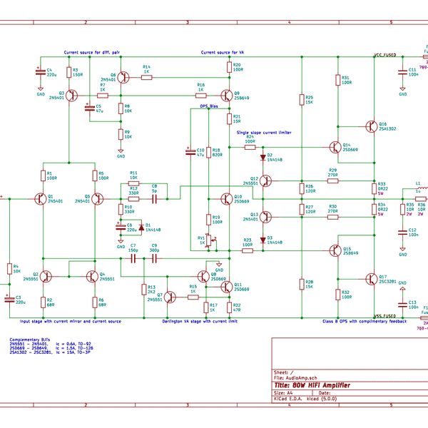

Class B is used in Push-Pull power output stages, often of audio amps driving a speaker. The advantage of course is that there is little or no quiescent Collector current required, thus keeping down the power dissipation (and the power supply size.) Here is a tutorial for some bipolar class B transistor circuits.
https://www.electronics-tutorials.ws/amplifier/amp_6.html

A few nits to pick here - what you describe here is a class C amplifier, which is only used in RF applications. In reality, the difference between class AB and class B can be very small. Take a look at the power amplifier schematic below. Here Q7 determines how much quiescent current the output stage draws - and the bias across Q7 is determined by P1. Thus you can tune the quiescent current by varying P1 - from genuine class B to class AB.
In real life, nobody would use a variable resistor for P1 - not because of the cost of the component, but the cost of having somebody measuring the quiescent current and adjusting P1 to the correct value. Therefore a fixed resistor is used instead of P1, the value having been determined in the development lab.

Are you talking about tube amplifier like guitar amp or hifi power amp type?
1) No, just because you are running class B with very low bias current does NOT mean you can use smaller supply. It depends on what power output you want. class A, Class AB or Class B has no baring on the size of the power supply, it's the required output power that govern that. Sure, if you don't put any signal, yes, your class B can use smaller supply, BUT as soon as you put in some signal, the amp will clip at much lower power.
2) Yes, generally there is this relation, the higher the power of the amp, the higher the voltage you need. BUT it's not absolute, for tube amp, it depends on the current capability of the tube, the output transformer turn ratio. For transistor amps, yes, there is a direct relation of supply voltage to the power output.
Q1, for tube amp, you need to match the output transformer tap to the load impedance, You don't get higher or lower power with 2ohm or 8ohm load, it's about matching. don't look at that other parameters. Tube amps are more complicated in calculation as you have transformer taping.
You have to put the schematic, give more information. I design tube guitar amps and SS hifi power amps. I need much more information to help you.
