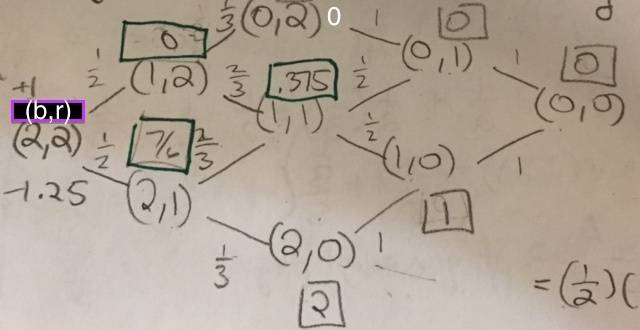

Imagine you are playing a game with me, of drawing balls from a box. There are two blue balls and two red balls. They are picked with equal probability, and are drawn without replacement. If you draw a blue ball, I give you $1. If you draw a red ball, you pay me $1.25. What is the expected value of this game to you if you are allowed to stop at any point?
I drew a lattice diagram that shows the value of the game in all the possible states of the balls.
(b,r) means that at this point, there are b blue balls and r red balls.
That is, something like this:
The boxed values indicate the value at each point in time, calculated recursively.
I was able to figure out the value of the game if you were required to play until the box was completely empty using a recursive method.
the expected value at any point (b,r), V(b,r) = max((b/(b+r))(1 + V(b-1, r)) + (r/(b+r))(-1.25 + V(b, r-1)),0)
where V(b,r) is the method of value of the game at the situation with b blue balls and r red balls.
So V(2,2) is the value at the beginning of the complete game, so it was 0.4583 approximately if we were required to play until all the balls had been drawn.
I'm not sure how to compute the value of the game to you if you have the option of stopping whenever you want. I was told it was (1/3) but I don't know how this number comes about. Can someone explain how the way you value the game given this option is different from the one above, and how it is calculated? Thanks.

I also get 0.4583 = 11/24, so I think you must have made a mistake somewhere.
V(1,1) = 1/2 * (V(0,1)+1) + 1/2 (V(1,0) - 5/4) = 1/2 + 1/2(1 - 5/4) = 3/8
V(2,1) = 2/3(V(1,1) + 1) + 1/3(V(2,0)-5/4) = 2/3(3/8 + 1) + 1/3(2-5/4) = 7/6
V(1,2) = 1/3(V(0,2) + 1_ + 2/3(V(1,1) -5/4) = 1/3(0+1) + 2/3(3/8 - 5/4) = 1/3 - 14/24 .it will become negative, so V(1,2) = 0.
V(2,2) = 1/2(V(1,2) + 1) + 1/2 (V(2,1) -5/4) = 1/2(0+1) + 1/2 (7/6 - 5/4) = 1/2 - 1/2(1/12) = 11/24

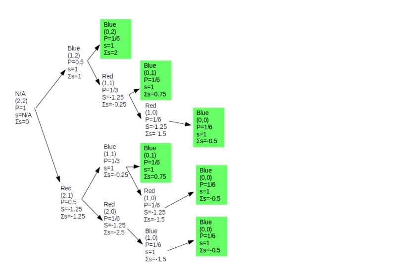

The attached diagram demonstrates the basis on which I calculated the answer to be 1/3. The payment to the player at each node is s. The probability of reaching a node is P. The leaves are shaded green. We add up Σs across those leaves, multiplying by the probabilities P, which are all 1/6, and we get 1/3.

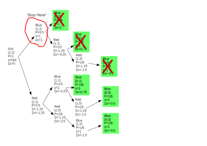

I've just realized that the value is indeed more than 1/3.
The algorithm that gives 1/3 only stops when there are no more blues, on the simple expectation that one can only lose from then on by further draws.
However, it can be advantageous to stop before then, even if there are remaining blues, because the expectation of payoffs from continued draws may be less than the expectation of stopping, which is 0.
That will be the case when there are 1 blue and 2 reds remaining, because the expected payoff from continuing to draw until the blue is drawn is negative.
In the diagram, that's the top node in the second column labelled
Blue
(1,2)
P=0.5
s=1
Σs=1
If we remove the descendant nodes of that node, making it a leaf, the expectation over the leaves becomes ##0.458\dot3##

and attached is a revised diagram.

You do have an extraneous arrow.
After initially picking two Reds, you have two arrows from that; one to a Blue (fine), one to a Red (not possible).
Your numbers are fine.
