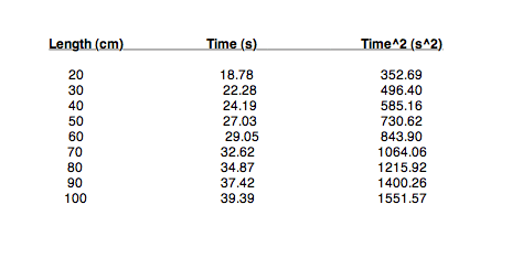

Basically, we were asked to do an experiment where we measured with a stopwatch for 20 complete oscillations for a pendulum bob swinging through a small arc (10 degrees). We increased the length of the string attached to the bob by 10 cm every time from 20cm to 1m.
Then, we were supposed to graph length to time^2 and figure out a value of "g" and give a straight line graph in the form of y=mx + c
Basically, i recorded data like this
Using Time^2, and Length, I plot the graph and drew a line of best fit in the form of y=mx + c. I got a slope (m) of 14.371
I used g = 4pi^2 / m
Where m is the slope of the graph.
Using the above equation, I subbed in all the numbers to find "g" for the first point of data.
So, g = 4pi^2/14.371
g = 2.747
My question is, as we all know "g" should be 9.8 meters per second ^2. I am getting a figure of 2.747 meters per second ^2. Which is awfully off what it should be right?
I am wondering if one of my equations are set up wrong, or did I measure something wrong?
What's the actual relationship in terms of length and period?
How does your measured value of "time" relate to the period of the pendulum?
Well, I know that length and period are used in this equation:
T^2 = 4pi^2L / g.
my measure of Time (s) is of 20 oscilliations of the pendulum.
and Period = time / # of cycles.
So is it what I am supposed to do is use Period ^2 instead of Time^2 ?
Am I supposed to use T^2 = 4pi^2L / g and bring it over to y = mx + c, where Period^2 is at the y-axis, Length at the x-axis?
Sorry, I'm still a little confused as to how to do this question.
T^2 = 4pi^2L / g.
Right. Here, T is the period, not your measured 20 oscillations.
Yep. Or rewrite the equation above in terms of measured time, instead of period.

Uh yeah, I think I was confused over using Time and Period. It should be period.
I got 1088.48 cm / s^2
I was wondering how to calculate the percentage error?
Is it ( 1 - (980 / 1088.48) ) * 100
Anyways, thanks for your clarification and help Doc Al
It's best to express your error as a percentage of the correct value.
