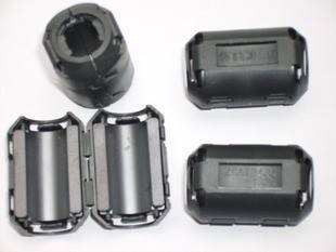

Possibly ...
You could try a clamp-on ferrite choke on the USB lead right where it enters the computer
that may emphasis on the word MAY :) cut the noise level down.
depending on the length of that USB lead you may be able to wrap a couple of turns through the ferrite choke.
clamp-on ferrite choke ...
cheers

OK, Thanks everyone for the help and support.
I will try the ferrite choke.
BTW, my wireless router is only 2 feet away from my setup so I'll also try moving further away from it.
If those things don't do the trick I'm not to worried. I'm still pretty happy with the oscope.
