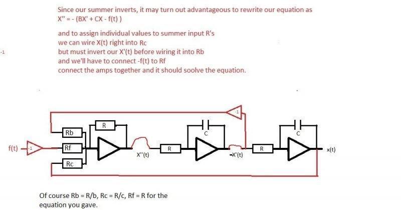

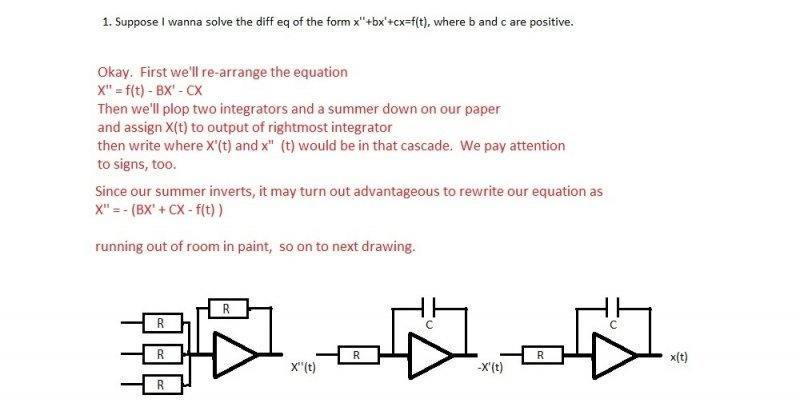

Here's the approach i was taught.. It' same as in that U of Illinois link.
It is cookbook and straightforward and it works. I well remember the day it "clicked" for me. I was stumped , just couldn't make sense of the process and was in danger of failing the course.
Upon solving the equation longhand then building the circuit and seeing the amplifiers replicate it, well it was an AHA moment. I caught up on all six labs in one weekend, got an "A" and made a professor very happy.
This process is so mechanical it's almost foolproof.
please excuse my awkward graphics...
I couldn't make sense out of that UCSD link it looks to me like they start from wrong end.
Now, there remain the matters of R&C values and initial conditions.
Initial conditions require initial charge on the capacitors. It's easiest to start at zero by shorting all the caps with a multipole relay and releasing it, surely your simulation can do that for you. My old analog computer used relays...
If you want real time solution make RC product = 1, less than 1 to speed up and more than 1 to slow down.
Your resistors across C change the equation, they're no longer integrators (1/RCs) but lag elements(1/(RCs +1))
I recommend you solve the equation longhand for first several seconds (maybe 0,1 second intervals with a FOR-NEXT loop?)
and compare that to your circuit's solution .
One cannot ignore the constant of integration, initial conditions .. Maybe that's the trouble with your simulation?

I think, the block diagram as shown by Jim hardy will fulfill the given task.
However, it needs 5 opamps.
It is possible to reduce the total number of opamps to three if the first adder is changed into a differential amplifier (feedback connections to both opamp terminals).
In this case, we arrive at a very popular universal filter circuit named after "Kerwin, Huelsmam, Newcomb": KHN structure.

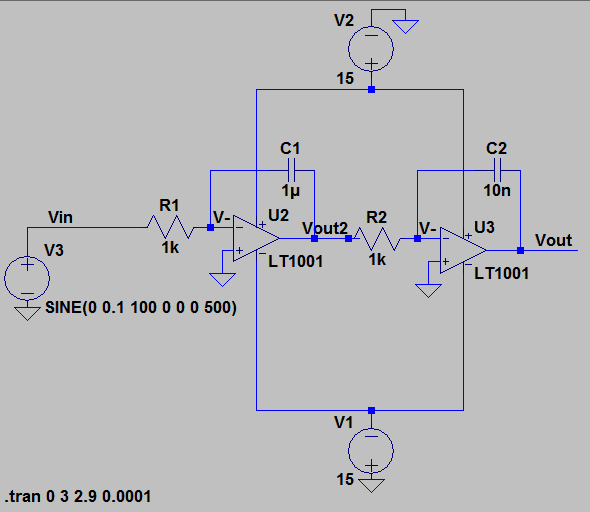

thanks for all the replies so far. Solving first-order diff eq is not a problem, but the problem is still the 2nd-order diff eq. I just try to have two integrators connected together, hoping that it will integrate the input signals two times. Suppose the input signal has the form sin(wt), then Vout2 should have the form cos(wt) and Vout should be like -sin(wt) (the integrator inverts the sign as well). But in reality Vout2 has a phase shift from the signal that is not pi/2 (meaning that the second integrator does have an effect on the first one?) and Vout is just the same as Vout2 with a slightly different amplitude. What's wrong? It works fine with just one integrator, but everything starts to go wrong after I add a second one.
Maybe.
Can you put up a trace of your outputs?
The LT1001 specsheet says its output is guaranteed to produce full swing only for loads of 1kohm or more.
See datasheet at
http://cds.linear.com/docs/en/datasheet/1001fb.pdf
page 5 chart labelled "Output Swing vs Load Resistance"Your U2 is asked to deliver current into both C2 and R1, oops make that R2 and C1...
so above some frequency (more precisely above some dv/dt) he sees what amounts to a 0.5kohm load, half the minimum in specsheet.
See if making R1=10K and C1=100nf makes him better behaved.
Or reduce amplitude of input 10X.
might be something else.
You already did first step of good troubleshooting, dividing problem in half by disconnecting second integrator.
Keep tightening the noose around that trouble's neck.
One step at a time. Test, observe, think.old jim
Ideally, two integrators in series will give a phase shift of Pi, not Pi/2.
Op-amps always have a phase shift 'error', and this gets worse as the frequency increases. You are noting this when the second integrator is not included in the feedback loop? How many degrees in error is the output?
The original idea with analog computing was that by time scaling you could slow everything down to a leisurely speed where electronics shortcomings vanished into insignificance, and you could use non-specialized consumer-grade plotters to record these slowly-changing waveforms. So we could, in effect, scrutinize the visual blurr of bounce and vibration in a jet's landing gear but do it in slow motion. We could then take the plot and, for example, relabel the horizontal scale from "seconds" to "milliseconds" and thereby have produced an accurate plot of the gear's realtime behaviour.
pi/2 at Vout2 looks right for his circuit.. pi at Vout (3 inferred)
i note there's no DC feedback to U2.
Integrators with no DC feedback tend to "wind up" toward one or the other supply rail after a short while. It's because they integrate their own input offsets.
So measure DC at Vout2, when it strays a few volts from zero you need to reset the integrator by briefly shorting C1. If this is a real not a simulated circuit short it through a few hundred ohms.
With LT1001's 4na input bias current your windup on U2 should be only 4 millivolts or less per second. i/c = dv/dt
So without DC feedback to keep integrators centered you have minutes of runtime on U2 but just seconds on U3.
Another troubleshooting experiment. Change your sinewave input to a square wave symmetric about zero.
Circuit troubles will then show up as waveform distortion not just phase shift, which can be hard to pick out by eye.
First integrator's output, Vout2, should then be a triangle shaped wave resembling saw's teeth.
If U2 is running out of drive capability you'll see flattened peaks.
This process is so mechanical it's almost foolproof.View attachment 80597
[View attachment 80601
