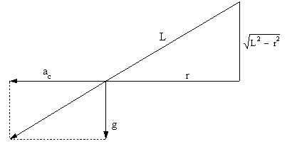

You can use the rotational motion form for centripetal acceleration, ##a_c = ω^2 r##, where ##ω = 2\pi/T##. A little algebra and you can find an expression for r that does not require sines or cosines.

The problem says that the period of rotation is 1 second, not 1 minute. So ω is ##2\pi/1sec##.
L is the length of the rope. r is the resulting radius of the circle that the mass follows at one revolution per second. ##a_c## is the centripetal acceleration acting on the rotating mass. g is the gravitational acceleration. You should be able to pick out similar triangles in the diagram. Equate the side-length ratios.
Yea, sorry you're right. 1 second.
Ohh, so the Theta in both Triangle Ac/g and Lr are the same, correct? So you can equate the two, like this?
Tanθ = g/ac
Tanθ = √1^2 - r^2
g/ac = √ 1-r^2
g/ (2π)^2 = √ 1-r^2
(9.8 / (2π^2)) ^ 2 = 1-r^2
r^2 = 1 - (9.8 / (2π^2)) ^ 2
r^2 = .938
r= .969
Thats what I get when I do similar triangles, which I am 99% sure isn't right. Is the g (.1)(9.8) or mg, or is it just 9.8?
QuickSkope said:
is the g (.1)(9.8) or mg, or is it just 9.8?
It's g, not mg. The mass canceled out.
Alright, so that makes both of them the same answer :). I end up with 0.97. Can someone do it and verify that that is right?

I agree with .97
