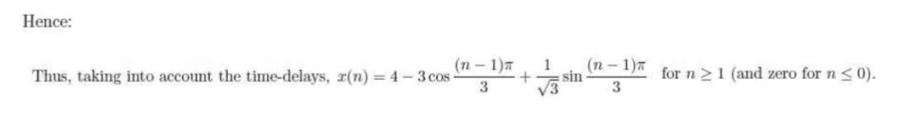

My apologies, maybe I should have actually listened and shared the rest of the solution. I sort of get what you're doing there, and recognise two formulas from the z-transform table. This is the rest of the solution:
Could it possibly be that the statement, 'Noting that the poles in the quadratic term are complex conjugates' has absolutely nothing to do with the decomposition, and in-fact, is aimed at what you've shown/ solution I've shared above?
When I went through the rest of the solution after breaking down the fraction, I was able to do the rest of the problem without thinking of complex conjugates. The two formulas I got straight from the tables, and after that, it was just a matter of identifying what's what. There was only one thing that confused me, which was why ##1/\sqrt{3}## was taken out. I assumed this was the case so the two terms in the final solution have the same term in the fraction##(\frac{n\pi}{3})##. I think if ##\frac{1}{\sqrt{3}}## isn't taken out, it would end up being ##\sin(\frac{n\pi}{6})##.
