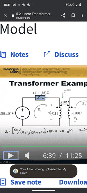

I am having trouble solving this equation, it is for an physics/electronics course
[50/(4+j3)(50)+100]x150
First I solved 4+j3, which I squared 4 and 3 to equal 16 and 9 then I added them to get 25 and then I got the square root of 25 = 5.
Then I plugged it back in to the equation.
[50/(5)(50)+100] x 150 to get 50/350x 150= 1/7(150)= 21.42. I've attached the correct answer.

The equation is for current in a circuit, it's in the picture that I've attached. It includes a complex number for the reactive properties in the current "4+3i" or 4+3j. When, I sive the equation for I1, I get 21.42, the actual number is 20 - 10j or 20-10i.

I would normally interpret that as ##[\frac {50(50)}{(4+j3)} + 100 ]150##. Is that right?
50 divided by (4+j3) x 50 +100
The denominator is(4+j3)x50+100
The answer that was given is 20-j10
$$\bigg [\frac{50}{(4 + j3)(50) + 100} \bigg ] \times 150 = 20 -j10$$
Yes, That is how the equation is given.

50/[(4+3j)x50+100]x150=20-10j

And yet:
$$\bigg [\frac{50}{(4 + j3)(50) + 100} \bigg ] \times 150 = \frac{150}{(4 + j3) + 2}= \frac{50}{2+ j} = \frac{(50)(2 - j)}{5} = 20 - j10 $$
