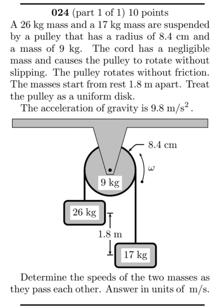

The problem is attached in the photo. The correct answer, according to the teacher's solution, was obtained using conservation of energy. Initially I tried using Newton's law/kinematics and got the wrong answer. Why didn't this work? Can you ever use Newton's law/kinematics to solve pulley problems (I feel like we did in class for some of them?)
Here are the two approaches with my two different answers:
Given:
m1 = 26 kg (the left block)m2 = 17 kg (The right block)M = 9 kg (the pulleyR = 0.084 md = 1.8 m

NEWTON’S LAW/KINEMATIC APPROACH:
Definition of torque:
(1) т = r × F
Newton’s Second law for rotation:
(2) тnet = тm1 + тm2 = I α
Combine (1) and (2):
(3) r1 × F1 + r2 × F2 = I α
Clearly r1×F1 points in the +z direction and r2×F2 points in the –z direction, so we can say that:
(4) r1 F1 sinϕ1 – r2F2 sinϕ2 = I α
I am assuming that r and F are perpendicular to each other in both cases (maybe this is the error in my logic?). In my free body diagram I drew r1 pointing to the left and F1 pointing down, and r2 pointing to the right and F2 pointing down. Anyways, if I can say that ϕ1 and ϕ2 are both equal to 90°, the above equation becomes:
(5) r1 F1 – r2 F2 = I α
Now given that:
(6) α = a / R
And, for a rotating disk:
(7) I = ½ M R2
And, force due to gravity is given by:
(8) F = m g
And, the magnitudes of r1 and r2 are simply the radius of the disk R:
(9) r1 = r2 = R
If we plug (6), (7), (8), and (9) into (5), cancel out the R’s, and rearrange to isolate a on one side of the equation, we get:
(10) a = 2 g (m1 – m2) / M
Because the net force is constant throughout, that means that the net torque, angular acceleration, and linear acceleration are constant throughout. Thus we can use the kinematic equation:
(11) v2 = v02 + 2 a ∆r, describing the motion of the m1-m2 system
Since we start at rest, v02 is zero. Deleting this term, plugging (10) into (11), and finding the square root of both sides, gives:
(12) v = sqrt{ 4 g (m1 – m2) ∆r / M }
∆r will be 0.9 m – they will each travel half of the initial vertical distance between them. Thus, I’ll replace ∆r with d/2. Simplifying this gives the final equation:
(13) v = sqrt{ 2 g (m1 – m2) d / M }
v = 5.94 m/s

CONSERVATION OF ENERGY APPROACH:
The law of conservation of energy, where the subscript M indicates variables pertaining to the pulley, the subscript m1 indicates variables pertaining to mass 1, etc.:
PEm1,i + PEm2,i + PEM,i + KEm1,i + KEm2,i + KEM,i = PEm1,f + PEm2,f + PEM,f + KEm1,f + KEm2,f + KEM,f
All the KE terms at the beginning are zero so we can delete them. PEM does not change so we delete that term. Thus, the above simplifies to:
PEm1,i + PEm2,i = KEm1,f + KEm2,f + KEM,f + PEm1,f + PEm2,f
Which can be rewritten as:
m1 g h1,i + m2 g h2,i = ½ m1 v2 + ½ m2 v2 + ½ I ω2+ m1 g h1,f + m2 g h2,f
Noting that I = ½ M R2 and ω = v / R, we have:
m1 g h1 + m2 g h2 = ½ m1 v2 + ½ m2 v2 + ¼ M v2+ m1 g h1,f + m2 g h2,f
Let h1,i = 1.8 m (the initial vertical distance (d) between the blocks) and h2,i = 0 m. Thus, the second term on the left can be deleted, h1,i can be replaced with d. Also, since the blocks end up at the same height in the middle, h1,f = h2,f = 0.9 m = ½ d. Thus:
m1gd = ½ m1 v2 + ½ m2 v2 + ¼ M v2 + ½ m1 g d + ½ m2 g d
Rearranging and solving for v gives:
v = sqrt{ [ (m1 – m2) g d) / (m1 + m2 + ½ M) }
v= 1.83 m/s
