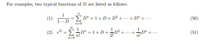

How does this relate to my question?
"And they continue by expanding using maclaurin series. How do you treat an operator as a variable? How could you possibly assign a value of zero to it?"

Biker said:
And they continue by expanding using maclaurin series. How do you treat an operator as a variable? How could you possibly assign a value of zero to it? How can you just take the reciprocal of it?
I'm not aware of an example about reciprocals, other than the one you gave, which is basically matrix exponentiation, and the historical origin of all this. But to get an idea of how to treat an operator as a variable, you could look at $$H=2x \cdot \frac{d}{dx} \, , \, X=x^2\cdot \frac{d}{dx}\, , \, Y=- \frac{d}{dx}$$ (here) and apply them to smooth functions in ##x##. Now these are a basis of a vector space, so liner combinations are allowed. Then it is also a basis of a Lie algebra, so Lie multiplication is allowed. At last, as a Lie algebra, here of the Lie group ##SL(2)##, there is a correspondence between the Lie group and its tangent spaces, the Lie algebra. This correspondence works in the direction ##\text{ Tangents, aka Lie algebra } \longrightarrow \text{ regular transformations, aka Lie group }## with the exponential function, in which case the operators become the variables of the exponential function: your example. See e.g. https://www.physicsforums.com/insights/representations-precision-important/.
Biker said:
I don't really understand how their inverses work.
For example, in solving 2nd order linear non-homogeneous differential equations.
The particular solution is found by
## y_{pi} = \frac{p(x)}{f(D)} ##
Is there any reference that discusses this?
You can't treat an operator as a variable, and it doesn't have a value. But you can develop a mathematics of such operators. You need to keep in mind that underneath, an expression like Df(x) is not multiplication of D by f(x). It doesn't behave like multiplication. For instance D meaning d/dx does not commute with x. Thus if you have Dx as an operator, meaning that it really appears before some f(x) in an expression like ##d[x f(x)]/dx## then by the product rule Dx = (xD + 1).
I think that the "Maclaurin series" ##e^D = 1 + D + (D^2/2!) + (D^3/3!) + ...## is actually a definition of the notation ##e^D##. It turns out to be quite a useful operator, but that expression was not "derived" by applying Taylor's Theorem to an operator.
As for something like ##1/D##, I think as your title line implies it's just a notation for the inverse of D. In ordinary multiplication, we define c = a/b as the value such that cb = a. Thus we would say g(x) = f(x)/D if and only if f = Dg. So (1/D) is an antiderivative. That's why @hilbert2 's response was an answer to your question.
And so 1/f(D) means the inverse of applying the operator f(D). I don't know under what circumstances that can actually be expanded as a Maclaurin series, but certainly it would take a proof to establish that's a valid thing to do, always keeping in mind that we are doing differential and integral operations here, not multiplication and division.

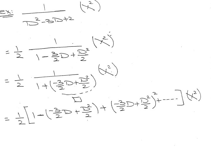

Thank you all for the responses. Sorry for the late reply.
Fresh_42, That is kinda advanced mathematics for me. I still haven't taken most of what you have mentioned.
RPinPA, Exactly. I understood the method of undetermined coefficients. Absolutely reasonable for me. I can also work with the D operator and proved mutiple theorems like exponential shift ..etc
However I couldn't for example make sense of why this is true:
How do I establish a proof that this is a valid thing to do?
Actually I might have proved it
Assume:
##(1-P(D)) y = x^n ##
Assume ##y = Q(D) x^n##
If this ##Q(D) = (1+P(D) + P(D)^2 ... )##
##(1-P(D)) (1+P(D) + P(D)^2 ... ) x^n ##
It is easy to verify that this is equal to x^n thus ##y = Q(D) x^n##
We have the rules of D operator for Linearity, Sum and multiplication but we don't have any rules for the inverse of D operator. So it can be defined as the above. Although we used Maclaurin series to get the expression for Q(D) But this only works because the operator has the algebraic properties mentioned above
Which is really interesting, I don't know how I didnt see this from the beginning :).
