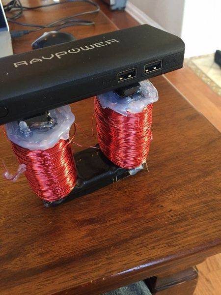

Hi guys,
I'm using an electromagnet to detect the presence of a steel door through analog pins on an Arduino. This works great if the magnet itself isn't under power, but once I'm running 12 volts through it, the sensitivity of the readings fall apart. I'm using a resistor based voltage divider to bring that signal back in.
Any ideas how I can get a more sensitive reading while the EM is under power?
Just thinking through this, is there a module available that might sit between the EM and Arduino to amplify resolution?
I'm not quite sure how your detector works ?

I've got a picture of it attached. The battery sitting on top is representative of the door that it's holding.

Does your detector need to be co-located with your electromagnet?
BTW, it's still not clear how the detector works. There are several possibilities, so ...
I suspect your problem is the change in inductance as the core of your magnet saturates. This could drop the inductance by 2-3 orders of magnitude. But it's hard to be sure without understanding the circuit.
If that's the problem, you might get by with a software fix. Simply use a different detection level when the core is saturated compared to when it isn't.
Oh yes, the detector ideally needs to be on the electromagnet side of the equation, hence my trying to use it as the detector. The way it's wire up, I have 12 volts going to the electromagnet, with a line coming off it that goes to an analog IN pin on the Arduino. I have a voltage divider to take it down to 5 volts for the analog pin. That's the basic circuit. Without power to the electromagnet, the Arduino (with 1023 integers of value to read) picks up an easily readable difference of about 300 integers with the steel door present vs. away. With 12 volts powered, that 300 spread goes down to 2-3, which is so small that misreadings are common.

Well I'm truly puzzled now ! With no power going to the solenoid I can't see what the AD converter is finding to detect the level of .
Are we talking all DC in your circuits ?
Could you draw out the complete circuitry of everything to do with the electromagnet and post it for us to look at ?
As Nidum is implying, you would usually use AC to detect nearby ferrous metal with your test coil. Does your Arduino have an analog output available? What frequency sine wave could you output with it?
This is all DC. I can draw up a circuit but it will be a little crude. Give me a few.
I am being persuaded that you are saturating your iron core.
When the iron core is saturated, it no longer multiplies the inductance by µiron(≈600). Instead it multiplies it by µ0(=1). If you can spare another tap and input pin, use it with a different voltage divider.
Of course there are other possibilities. As the other posters alluded, transformers don't work with DC. Are you checking (and adding a check current) less often when the magnet is energized? (I assume you do something like this many times a second to get any result at all.)
